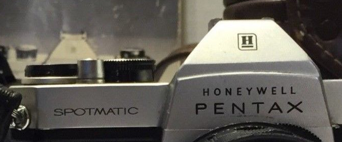

Here's a little exercise for y'all...can you spot the defect with this eBay item ? I've cropped the image to make it a little easier....

Is the prism housing crooked or is that just the lighting. The area under the H and above Honeywell looks lower on the left.

Yeah, the pentaprism looks crooked to me, also.
Where is shutter release?
Good eye. The hot shoe is a little bent...but that's not the most serious defect with this body.

Thought so. If the problem is what I think it is, I can fix it in under two minutes.

Took me a little more than two minutes (more like two hours) and it's still not quite right. The issue seems to be that someone spilled something sticky (Coke?) on it some years ago, and just let it sit. The poor thing is in pretty sad condition. It is an SPIIa so kinda cool but...it really needs some work.

The problem may go further than just a stuck shutter button. Coke is quite acidic and may have caused some corrosion inside the body. It will dissolve rust and the corrosion on lead-acid battery terminals. Good for cars but not cameras.

now you're on to something....the shutter release button...it is there but stuck down. This camera is locked up.

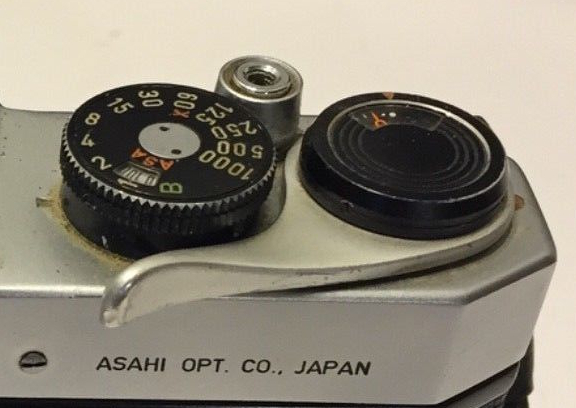

I wasn't sure until I saw this picture.
