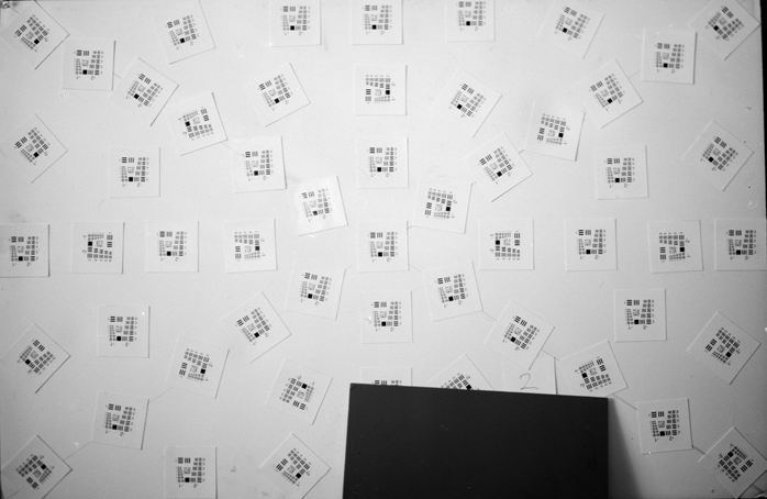

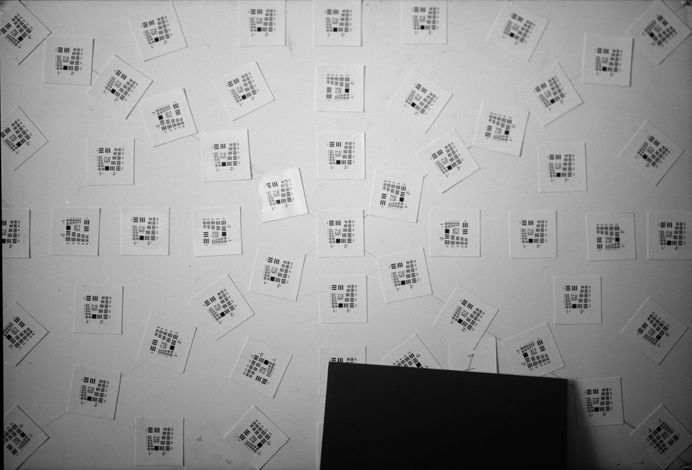

While all of your lens are considered very good to excellent but you will have to ask them if they preform good enough for you.
The Crown Graphic Special was introduced to improve sales to a slumping company. The Xenar was supposedly less sharp than the Optar used on the higher priced Crown Graphic.
Fast forward to about a year ago. I repaired a 4x5 Crown and the owner had a 135mm Optar with heavy fine scratches on the front element and a clean 135 Xenar.
I have a 20 x 30 inch piece of white foam core with 2x2 inch USAF1951 test targets printed at high resolution on glossy photo paper attached in an X pattern and a + pattern in the center with some of the targets turned a various angles. I measured from the film plane on both sides to the target sheet and got them within 1/8 inch of each other. I photographed the target with both lens loupe focused on the center of the target on 4x5 sheet film. The scratched Optar was sharper in the center than the Xenar but softer on the edges, the sharpness of the Xenar was the same from center to edges.

They were customer supplied. The Optar looked good from the front but looked like it had been cleaned with sandpaper from the rear, all scratches on the outside of the front element.
Optar.jpg Optar; Xenar.jpg Xenar. Lighting wasn't great but adequate for the test.
