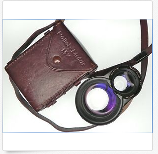

Can you put the Rolleiflex tele lenses in a 2.8 camera?
This is what you would need.
