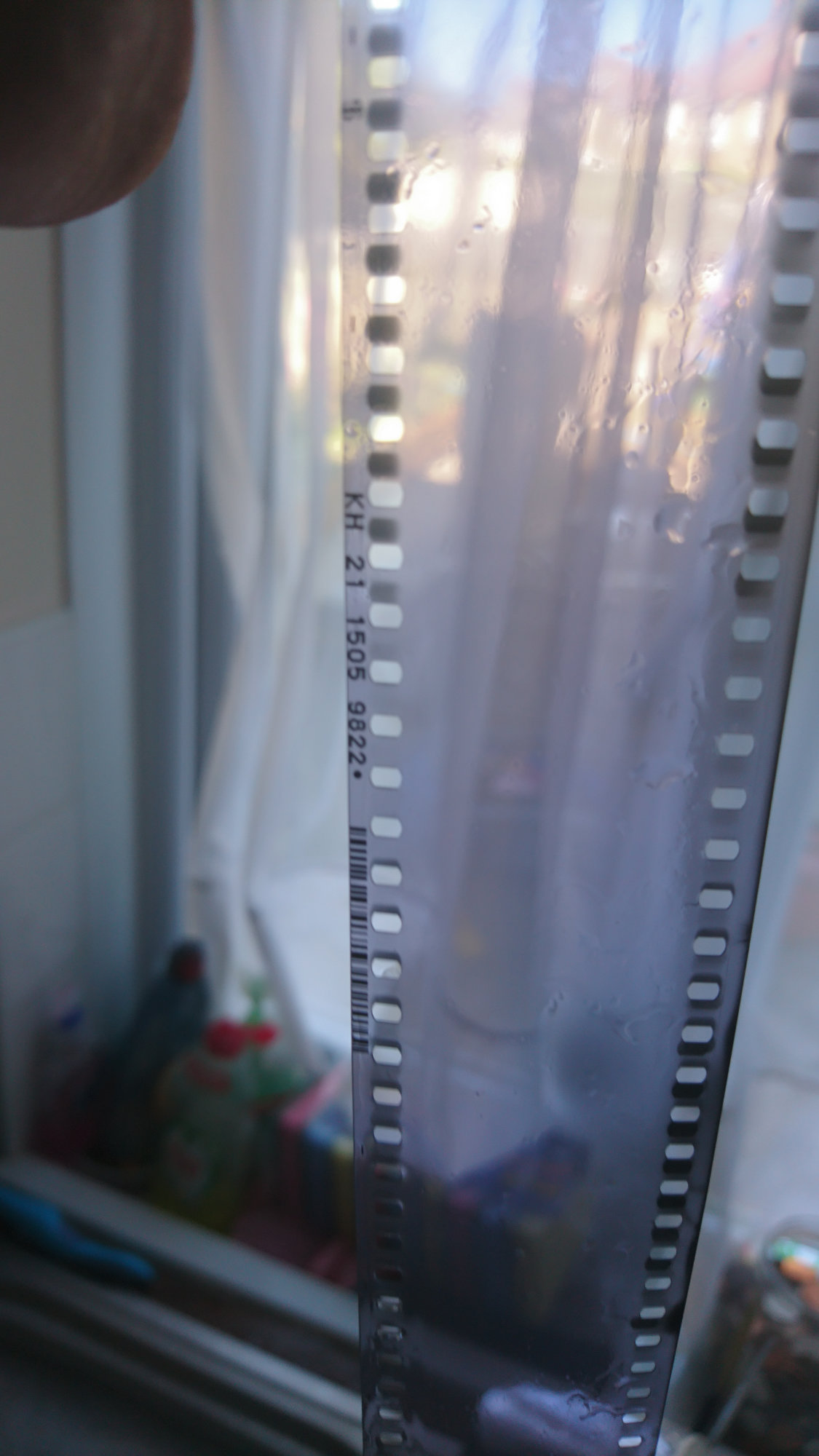

Hi all,
I've come across a bulk roll of film in the back of my stash that I can't identify. The label is ripped with the only discernible text being '125ASA' which should narrow it down a bit. I cut a bit off and developed it in RO9 1+25 for 5 minutes in the hope that it would tell me what it is but the only text printed on the film (other than numbering) is 'KH 21 1505 9822+' which doesn't tell me much; I was hoping for it to actually say the brand/variant.
The 5 minute develop time seemed about right to bring the text out nice and clear so I expect the dev time of the film should be around this figure, maybe a minute or two longer. The majority of film I have bought over the years is Adox, Kentmere and Fomapan, but the film can be ripped by hand so I doubt it's a Kentmere (from experience Kentmere will not tear at all) that said though, I have had a habit of buying random old films off ebay to play about with so it could be anything.
So... quick recap of known variables
Speed: 125
Text on film: KH 21 1505 9822+
Develop time: Around 5-7 minutes in RO9 1+25

Edit, looking at http://www.wikiwand.com/en/Film_perforations they appear to be BH with the very slightly curved corners which would make it post 1989, but it's hard to tell as it's a very small curve.
I've uploaded a photo of the film:
As far as I can tell it's acetate based.

The barcode on the edge of the film doesn’t seem to follow any known DX style that I’ve seen on any film that I’ve developed. The character/number sequence is probably what is coded into the barcode, which means it’s probably meant to be handled by a machine.
AgX
Apr 5, 2007
29,972
Germany
No modern still film has BH perforations.
This film is a cine camera film.
Cine films have their own system of coding, for instance Kodak's Keycode.

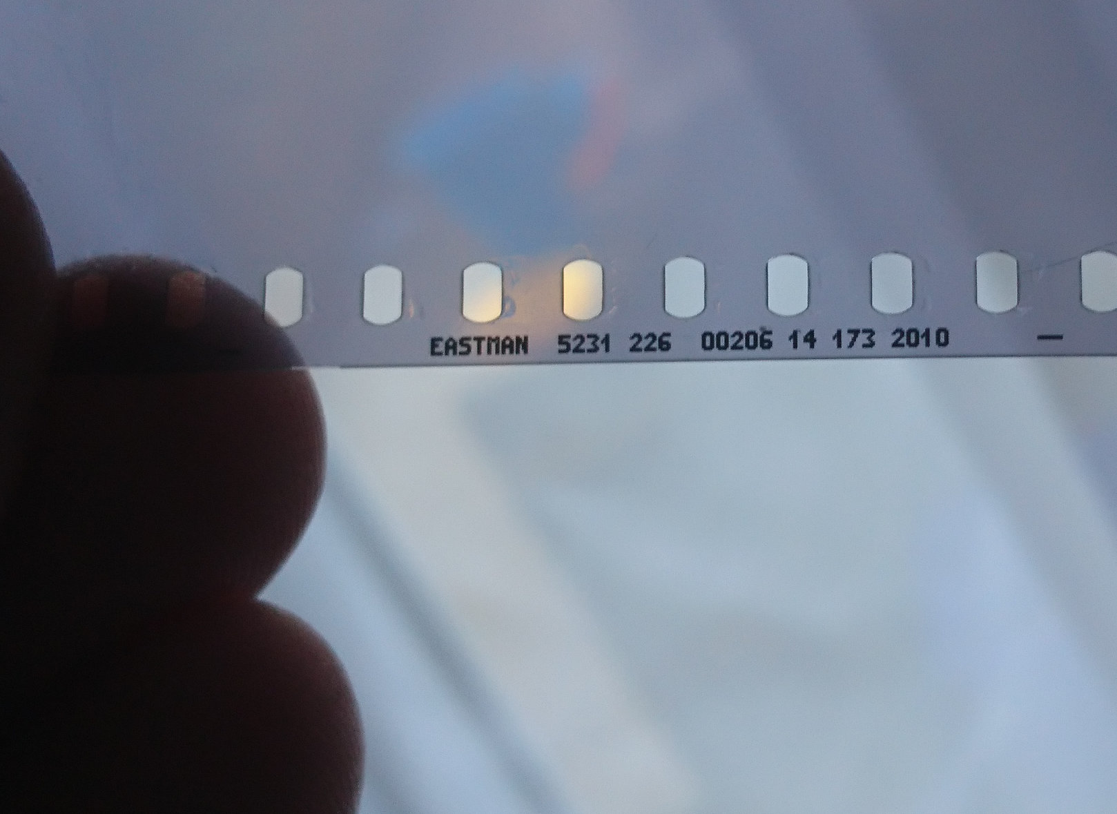

It turns out I didn't develop enough of the film to identify it. After developing another couple of foot I came across the text: Eastman 5231 226 00206 14 173 2010
According to the Kodak datasheet at http://pdfstream.manualsonline.com/7/7f2018da-8685-406d-ad38-bd336adf4e74.pdf Eastman 5231 is 35mm Kodak Plus-X Cine film. The final part of the code is also the year.
So, the film is Kodak Plus-X 35mm cine from 2010

Your images show a Kodak Keycode, the first image showing manufacturer, film, roll number and frames count per 16 frames.
The second image shows manufacturer, film, emulsion number, and production year.
