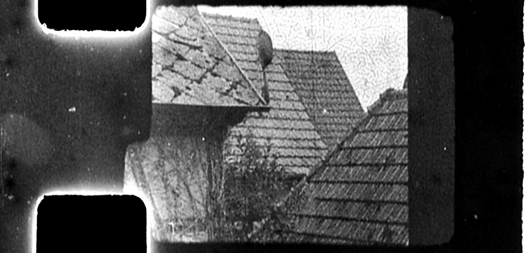

I'm collecting old movie cameras, and I'm experimenting a way to cheaply test them all.
So I developed small portions of 16mm Fomapan R 100, here are the details :
(I am beginning with a 1938 Kodak Eight movie camera , exposing 1/30sec f8.)
all liquid temp is 16°C
- bleach with hydrogen peroxyde 12%, and citric acid 20g per liter, 20mn
- washing 5 mn, developing with HC110 B solution, 20mn
- fixing for 5mn, washing 5mn.
The result is a slightly yellowed negative, slightly under developed (or under exposed ?)
My problem is the "marble", or "crackles" that is appearing, I really don't know where it is coming from.
Maybe you can help ?
Thanks a lot !

Too little agitation, probably in every bath. Bleaching acts concentrated in spots.
Change to a workflow in the dark with open tubs wherein you can move your spiral around. You will be able to cut bath times by 50 percent. I have processed motion-picture films of all sorts professionally and commercially for many years. Best practice I happily share with everybody. Bath temperature should be 20 degrees Celsius minimum.

Réticulation de la couche photographique. Tu développes trop longuement. Bien agiter, raccourcir le temps dans un bain
J'ai vu dans les forums que le fomapan reversible doit être développé plus longtemps, d'ou mon temps de 20mn. Mais c'est déja un peu sousex, si je reduis le temps de moitié par exemple, je risque une sousexposition encore pire, non ?
That structure is called "reticulation", it is due to extreme shrinking and then rupturing of the emulsion.
It is nowadays lesser seen than in the past.
It is typically due to strong temperature changes during processing. But strong ph changes may be of influence too.
Foma emulsions are known to be of lesser strength.
Thank you AgX for your reply. Yes I was rather light about testing the temperature. I will do my best and do some testing again with more accurate temp measuring, thank you again.

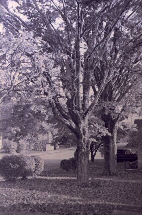

Fomapan R100 can't be developed as a negative.
Dec 29, 2018
982
USA
Traditional
Foma's R100 stocks are relatively more durable when compared to the Fomapan variants, but still isn't immune to emulsion softening & reticulation, even when using Foma's official permanganate-based reversal kit.
If you haven't already, search these forums for 'peroxide bleach' and you can find examples of others using the same or similar formula for B&W reversal and the challenges they encountered.
Indeed, the silver based anti-halation layer makes direct development to a negative produce less-than-ideal results.

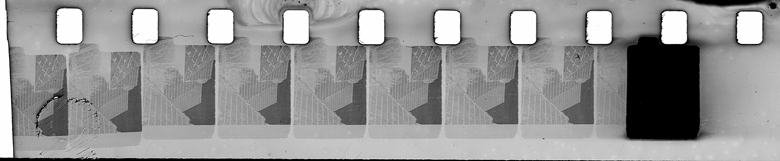

However for testing the mechanics of a camera (frame steadiness etc.) it should still work from what Bronson just showed.
(Well, it was just about saving hassle, sooner or later at full-length processing the reversal process has to be handled anyway...)
Thank you Bronson for your informationand your picture, it is very useful.

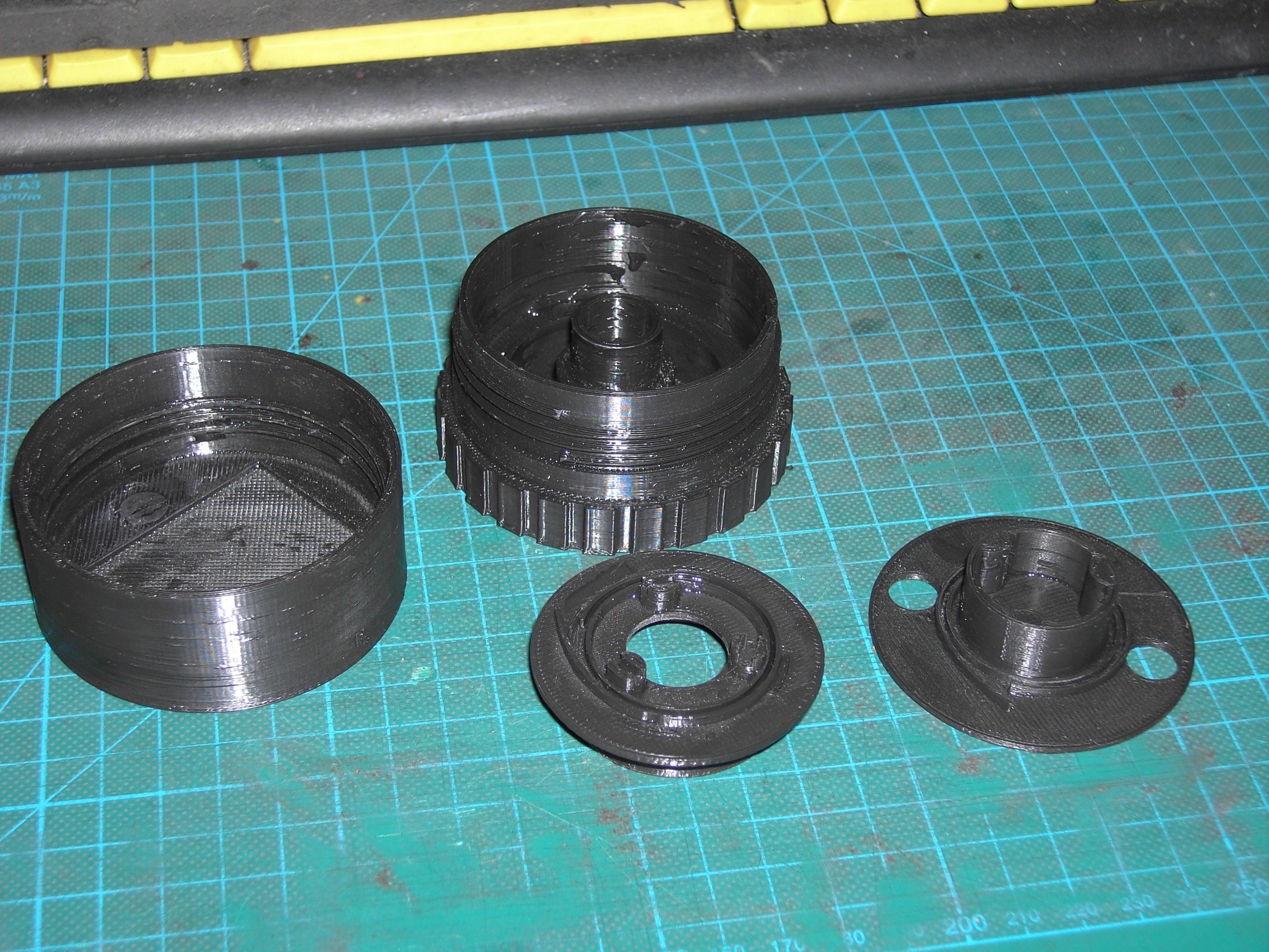

Well, I find that tank not uninteresting...
A tiny tank for test-processing a short film strip in a less than normal bath-volume. Maybe heightened for 35mm.
Worth a thread on its own.

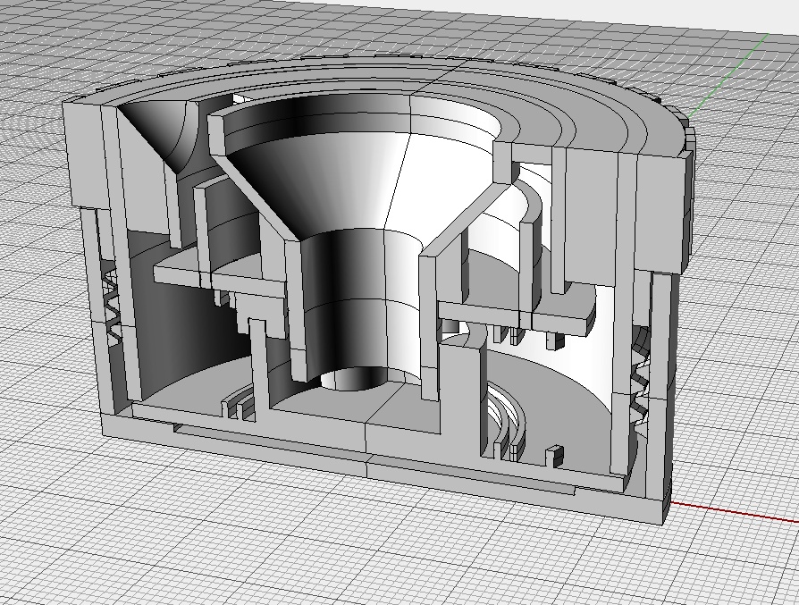

Thank you ! I designed it to develop a 10cm slice from a 2x8mm film reel, it only takes 50 ml of liquid to develop a film. It is very lightproof, and waterproof, but not designed to reverse tank.

Well, you could redesign the funnel so that it takes a lab rubber-stop. Or give it a thread to accept a beverage or lab screw-on cap.
AgX
Apr 5, 2007
29,973
Germany
It might be an outcome for experimenting with rare or expensive processing baths.
BUT there is a commercial alternative: use a 1x 35mm tank (in your case with a 16mm reel and just push-in a 10cm strip, rotate instead of invert and use the minimal volume to wet that strip.
