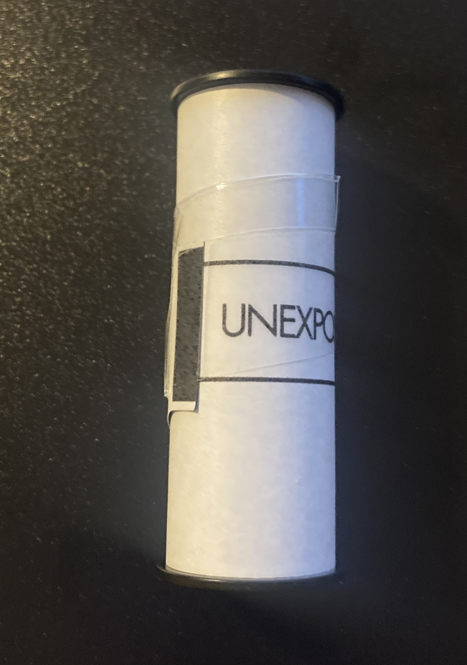

Bought a film back online and found a roll already loaded with the arrow lined up. But the backing paper is not routed correctly, so likely it’s not exposed. I rolled it back to find no identification markings. Any ideas what it could be? Anyway, I plan to shoot at ISO100 and develop in HC-110 or Rodinal, what could possibly go wrong, right?

Obviously this is no evidence, that it is Fomapan 100, but I do know, that Fomapan uses this nondescript backing paper. I also know, that not many films use such nondescript backing paper.
Wish you best luck exposing and developing this thing ...

Load the film onto a reel and put it in the tank, turn on the lights and check the backing paper to see what film it is.

I had a similar problem a few years ago. I loaded the film on a reel, closed the tank and then looked at the paper from one end to the other. The beginning of the paper told me that it was Rollei film. I suggest that you try the same thing and then examine to length of the paper. Also you could cut a little film off the end, develop it so you can look at the imprint in the rebate area.

In these modern times, when minimum order quantities are so high from the remaining backing paper supplier(s), and 120 film sales volumes are so low, backing papers look very similar to each other.

This is Ilford paper, you can roll the film onto an empty spool, then see the specific film on the exposed label. After that, just roll it back onto the original spool, making sure to keep tension on the film as you roll it up so you don’t get a kink.

I cannot find a supplier of backing paper to save my like, and I’ve asked everywhere I can think of. You would think the 120 width film would be the hardest thing to get for MF bulk rolling, it’s not lol. But this is definitely Ilford. Foma/rollei would have writing saying it’s 120, Kodak and Fuji would be… well, Kodak and Fuji, and Shanghai uses similar paper to Fuji. Only edge case I can think of is that maybe it could be CineStill or CatLabs, but it’s much more likely to be Ilford.

Looks like a roll of Arista Edu 125, which these days is Foma but in the past was Ilford.
Whatever it is the chances are it's ASA 125 or so and can be developed with Ilford's FP4 instructions (or Foma's, if you are so inclined).

Well, turns out it's Delta 100, and it developed fine. $60 for a GX680 film back is not a bad deal, the bonus film makes it even sweeter
