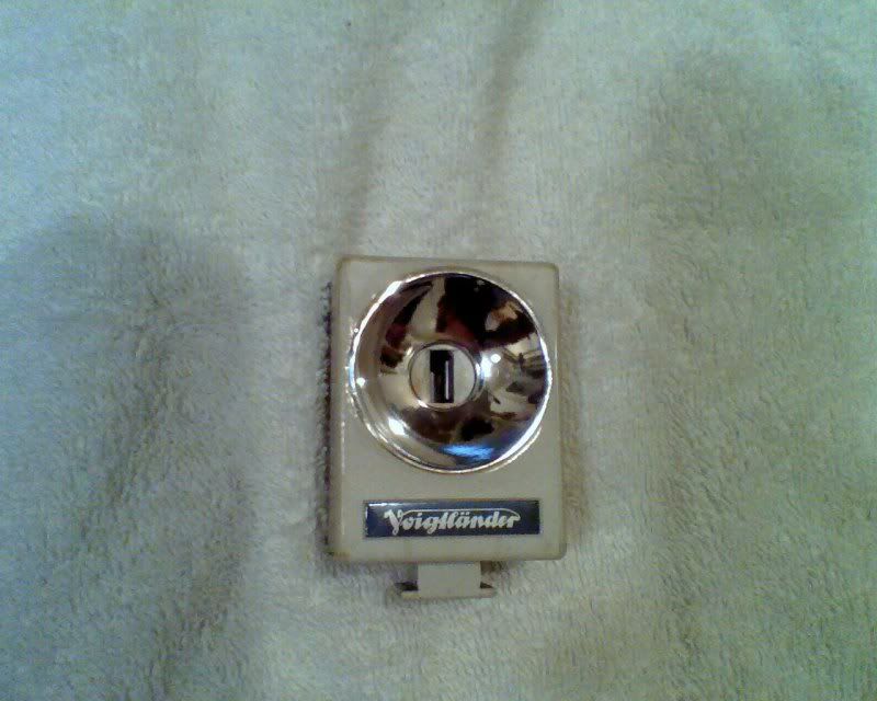

First photo, is from left to right, some kind of handle...I don't know if this is for a camera or what. It seems very well-built though, so it must be old. In the middle is a Honeywell device with rotatable silver reflectors. It looks like it could be a flash for old flashbulbs, but the socket is very strange. I don't know what flashbulb fixtures look like. On the right is probably a flash too but the socket is different from the one in the center. Can one still buy flashbulbs anymore?

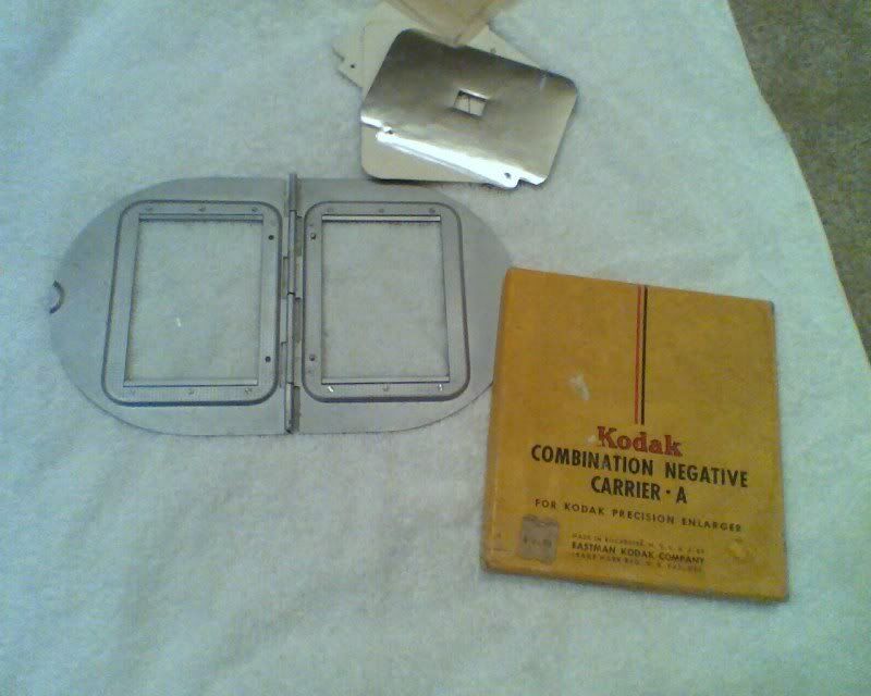

The next photo is of a glass negative carrier, but the packaging doesn't say what it is to. Any idea what enlarger this fits?

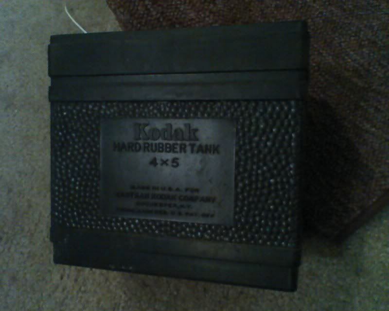

The last photo, and I have three of these, are hard rubber tanks. I've never processed sheet film so I'm trying to figure out how these were originally used. I think they must have been used to soup 4x5 sheets that were somehow dipped into them. They are made out of real hard rubber and not plastic.

3) at the right, ??? (no idea).

1) That is a negative carrier for a "Kodak Precision Enlarger" (see the box :smile:).

1) the hard rubber tanks are used with film hangars. You insert the sheet film into the hangar, which hangs upright in the tank. You agitate by lifting the hangar, tilting the hangar, and then replacing the hangar, in a particular pattern (and in the dark, unless the film is orthochromatic). Others here have much more knowledge than I about these.

The rectangular device is not detailed enough in the photograph, but it might be a light meter that clipped onto the flash gun shoe mount on the top of the camera. Seeing the detail of the dial, and perhaps the front of the device, would help in identifying its function.
The negative carrier and mask looks like one for 16 mm or Minox negatives. Knowing the dimensions of the rectangular opening would identify that.
Nice deep tanks for developing 4 by 5 film.
Sorry, the bit on the right is flipped over in that photo. It seems like a flashbulb flash afterall.
Meggaflash does not make AG-1 flashes nut they can usually be found on ebay

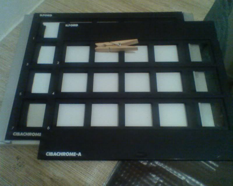

Ok, now how about these interesting things? They say "Cibachrome a" on them and look a lot like contact printers. It's a white base and two black tops that have numbered rows of windows in them. It really appears as if these are designed to make contact prints of 35mm color slides onto Cibachrome, but that sounds extraordinarily expensive and pointless, considering you can just look at the slide just as easily.
Making Cibachrome proof sheets for filing?
They may not be ,but when I first started using cibachrom we used sheets like that .they had individual little windows with colored filters to view the print and help you determine color correction. Did not have color analyzers for fhototogs back then.
Well they don't have any colored filters as they are now, but at least it helps me to rest my mind over their use. Thanks for the info.
Sometimes I soup my roll film in those large tanks. I "string" the reels on homemade brass rods, with a T at the bottom. It means sitting and whistling in the dark (actually listening to Mozart) until the film is in the fix tank, but that is a small price to pay for the convenience. Some folks say that gives more even development than inverted SS tanks, but I have never been able to tell the difference.
