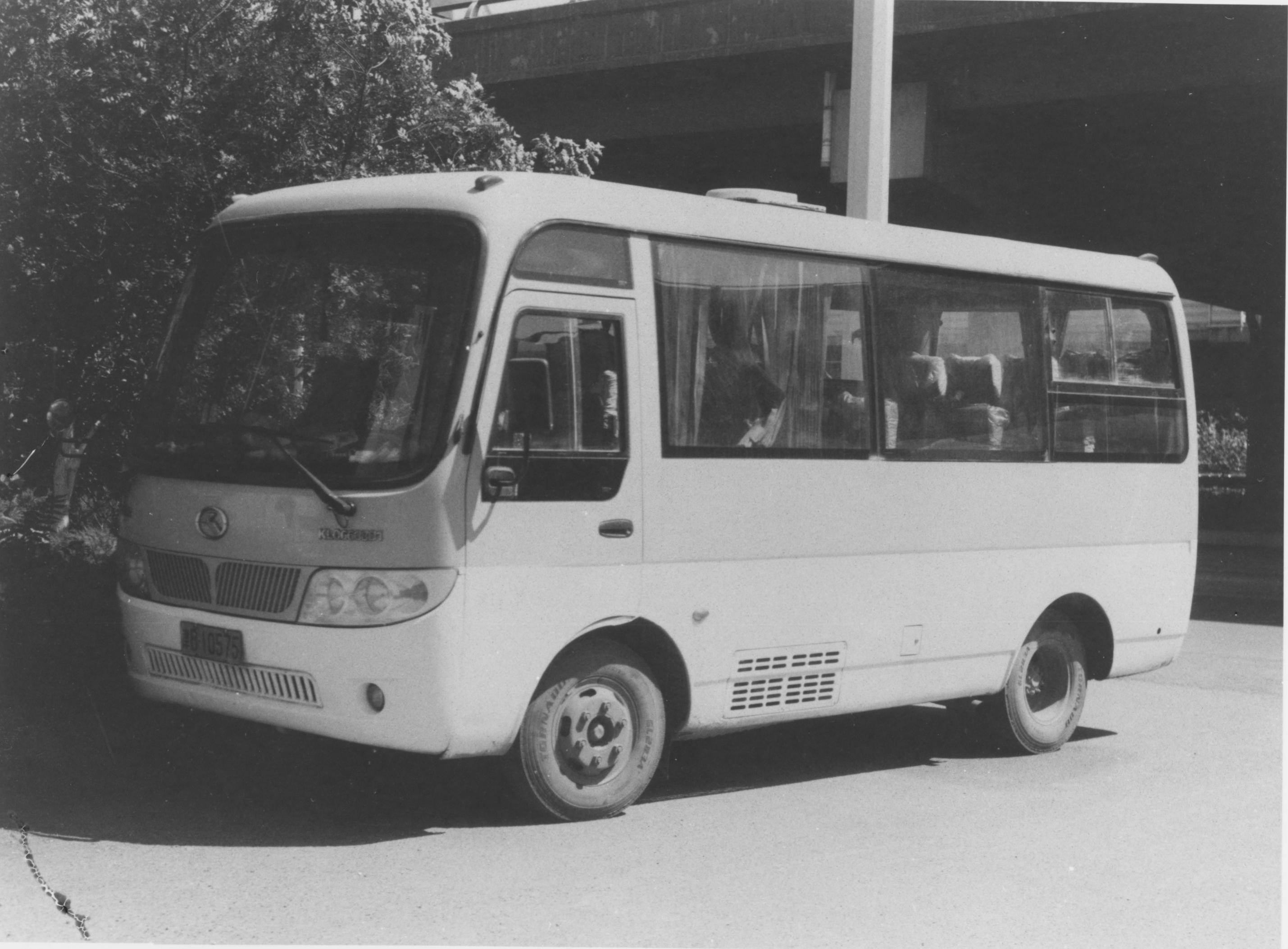

I enlarged a fuji fp 100C negative in bw paper you can see the photo has high contrast and lack of hierarchy. On the other hand, the negative is fragile, it has scratch when l bleached negative.

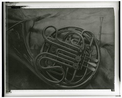

Now that I've had a chance to try it, I really like this and plan to do more. Here's the one I tried yesterday just as an experiment - the print is 8x10. Time-wise, it's right in the range I expect for regular negatives. I think it printed easier than they scan, too.
