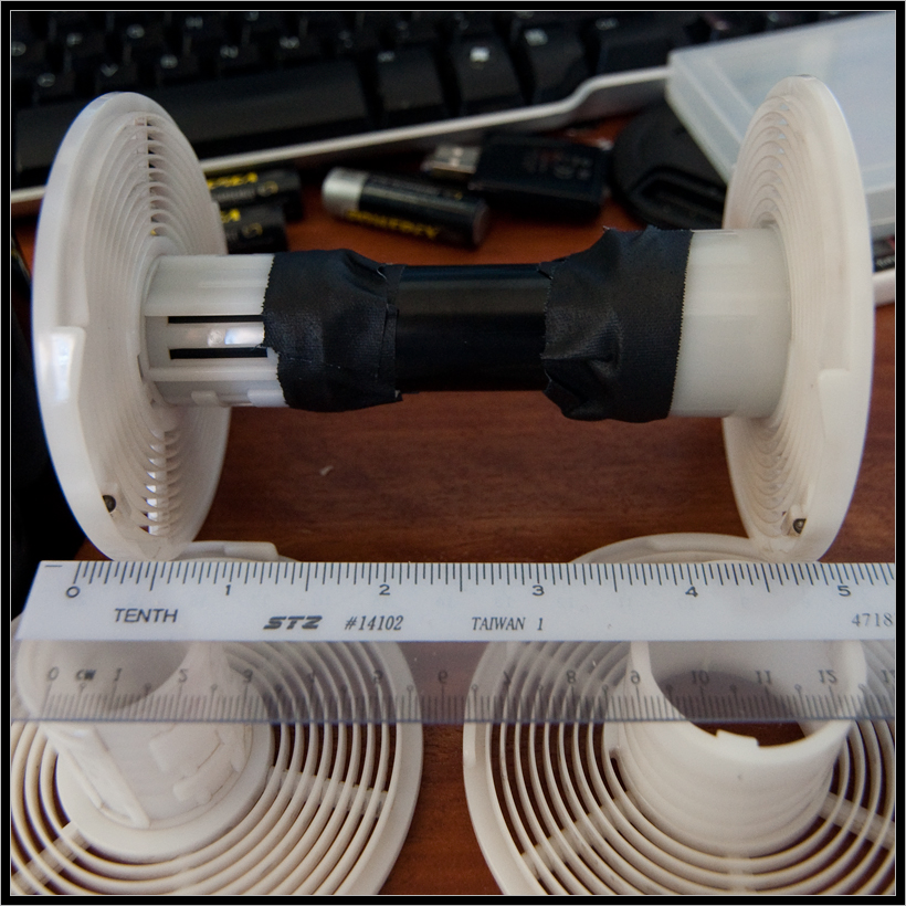

Anyway, keithwms, I took your idea and using my existing Paterson 3 Reel Tank I think I manage to come up with a holder.
As I don't really own any LF equipment yet (pardon me, I'm still doing a whole load of R&D before deciding) may I know if
the film thickness for a LF negative say is roughly the same as those of medium format?
If it is, then I guess the above may work, and development shd be pretty ok on both sides on the film using the Reel

Good start neoro! That's kinda similar to what I have. The issue with the sheets is that they have no natural curl. So they will not want to follow those tracks. Maybe if you precurl them....
But the thickness isn't too different from MF film. It is a bit thicker. But there are also different thicknesses in LF, some bases are thin, some are thicker. If you want to experiment with an inexpensive film, try the ortho films at freestyle. They are quite thin.
I am still working on making my funny holder work, but frankly I am not really sure it's worth the effort!
