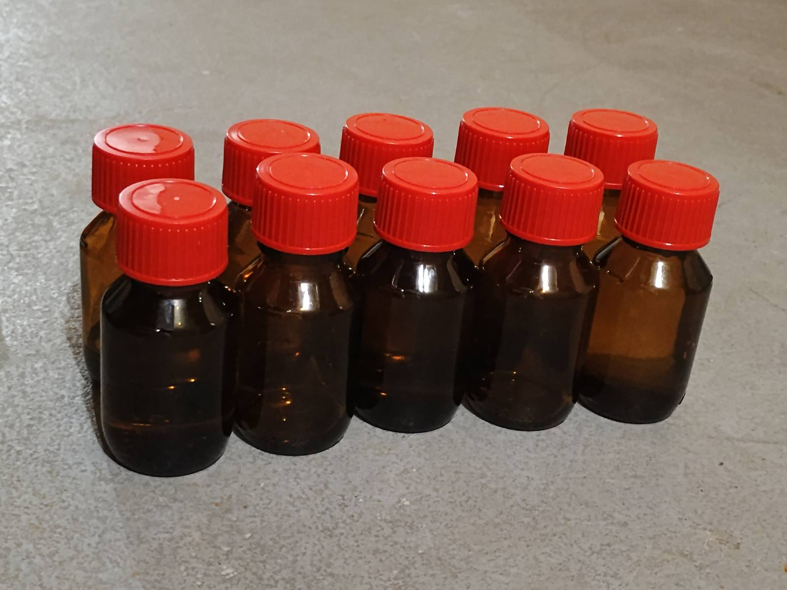

Sanug
Sep 27, 2023
321
Duesseldorf
35mm Pan
I mix the 1 litre package Adox XT-3 with the half amount of water and fill it into 10 pieces of 50ml glass bottles. When I have to develop a film, I dilute properly to get 1+1, 1+2 or 1+3 one-shot. It is very convenient and keeps the concentrate fresh until it will be used.
Don't try it with D-76. It will fail.
