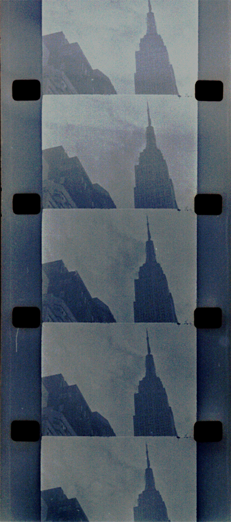

Ektachrome in Nescafe
Hello, this is my first reply on apug. I use KODAK 16mm Ektachrome and Tri-Reversal at work a lot, whenever I do my own test batches I've never had a problem with the anti-scratch layer. Then again I always do at least a 10min final rinse. I have done Double X 16mm in Nescafe just last week and it came out. I will scan it asap but i gotta look thru my recycle bin. Why not shoot in Tri-X or DoubleX since the Caffeic Acid only develops the silver and doesn't affect the dyes (at least from what I've seen in my tests) otherwise, why not try tri-x or dbl-x since it would be less expensive?

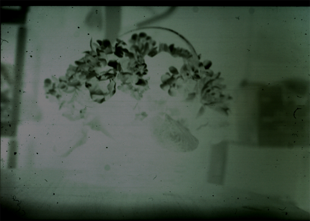

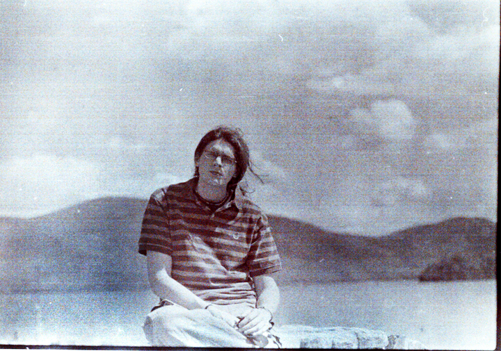

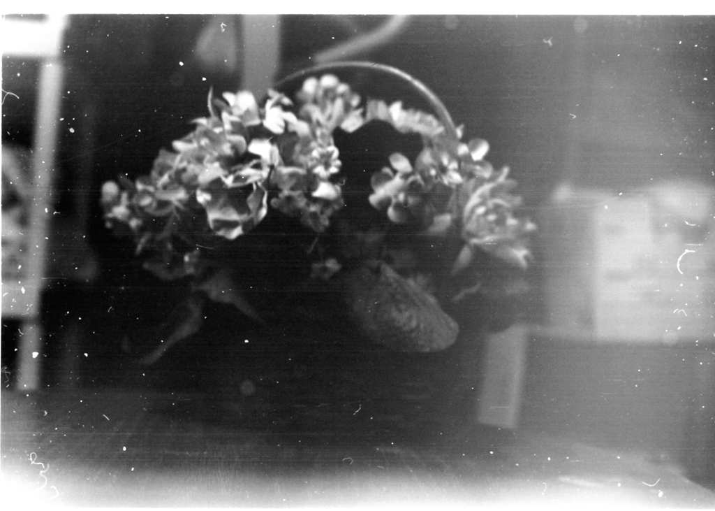

the hairdye treatment
for my friend in turkey: to my great fortune i found a spool of undeveloped ektachrome! so i tried it out in 6ml/10oz water hairdye for 40 min at 70 F with minimal stirring, washed, then fixed washed and final rinse and it works! not the best scan (my scanner is horrible) some color information is evident. also as for b&w I took some snaps on old Valca 6 Din Ortho (f5.8/15secs) and developed that in 10ml h20 and 10ml hairdye for 15min at 70 F and it works, but very slowly as my negs were thin & underdeveloped and needed to be scanned at lowest brightness.

i just eyed it, no strict measurements. and I used water from the tap. I will try longer dev times also see how it works on paper:smile:
