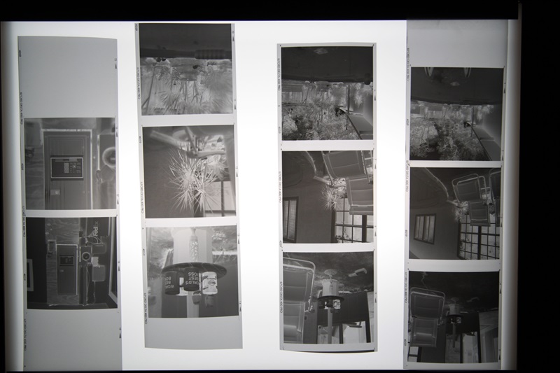

as promised:
attachment.php

Kirk,
Your negatives look just great. I wouldn't even call them overexposed (but then again, I like dense negs). They should print just fine.
Best,
Doremus

Kirk,
Best,
Doremus
I do too for good reason;the detail in dense highlights can easily be recovered by burnin-in during printing.:smile:
