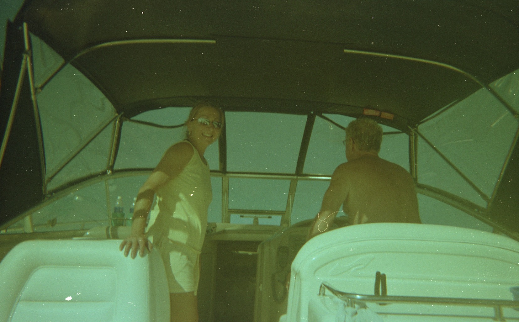

I've only scanned about 4 images... please keep in mind this was shot with my mom's "underwater" camera which is a plastic thing that came with crappy film loaded in it, was never re-loaded with better film, and was shot by amateurs and was shot almost 10 years ago and just recently developed, so the terrible color shifts are normal-ish I would assume, but there is the presence of pink, and hair apparently... I don't think this is all Rem-Jet, and seems typical for this lab from my 20 years of using them, though they did just get a new machine which they are "still trying to figure out" as the lady who could barely speak english said. Nothing against her as that's not what I mean, she actually seemed very intelligent, just not well versed in the english language, and since all the menu screens and directions were in english, I'm sure that could be a hindrance to her learning to operate the machine.

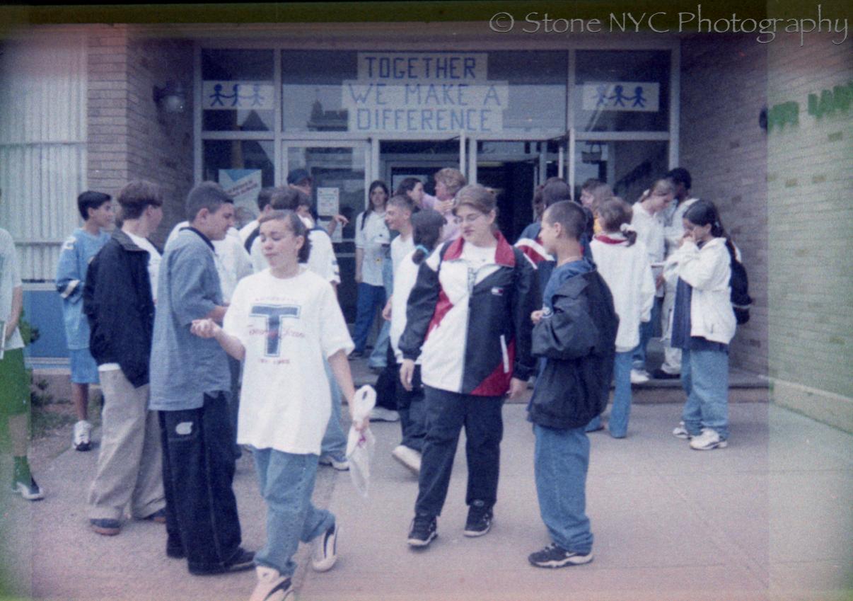

Now, to compare, this is an image processed by them when I was 12 on Gold200 shot with my AE-1
when I was 14 on no name 110 CN film shot with I think a Pentax 110 camera I had...
When I was 16... with the AE-1 again on Fuji800 CN of some kind
They've always had inconsistent color and lots of fiber and spot issues, even in the prints they would give me.
