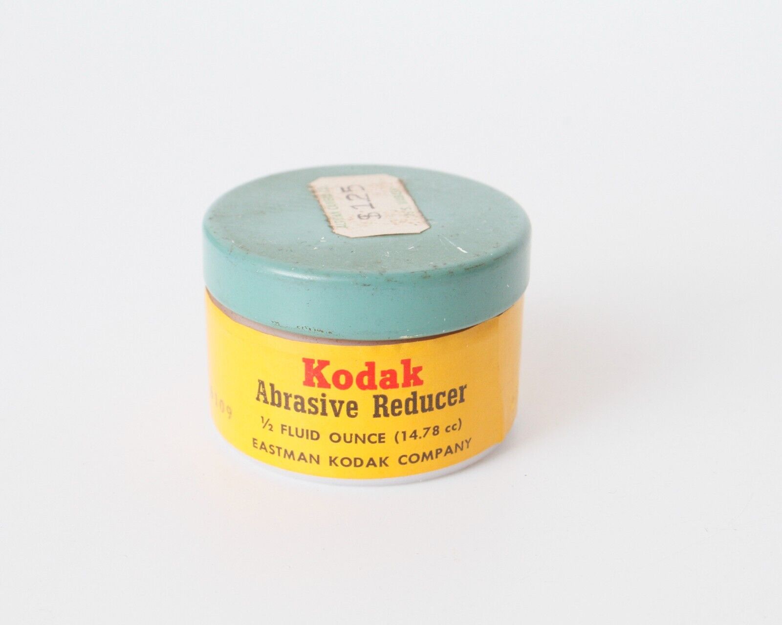

This is the old Kodak, emphasis on old. Basically a sort of rubbing compound. It would be tricky to try to remove the surface stain and not have it look weird.
