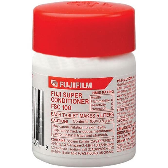

This is the Fuji final rinse.
Modern film doesn't need a stabilizer bath.
