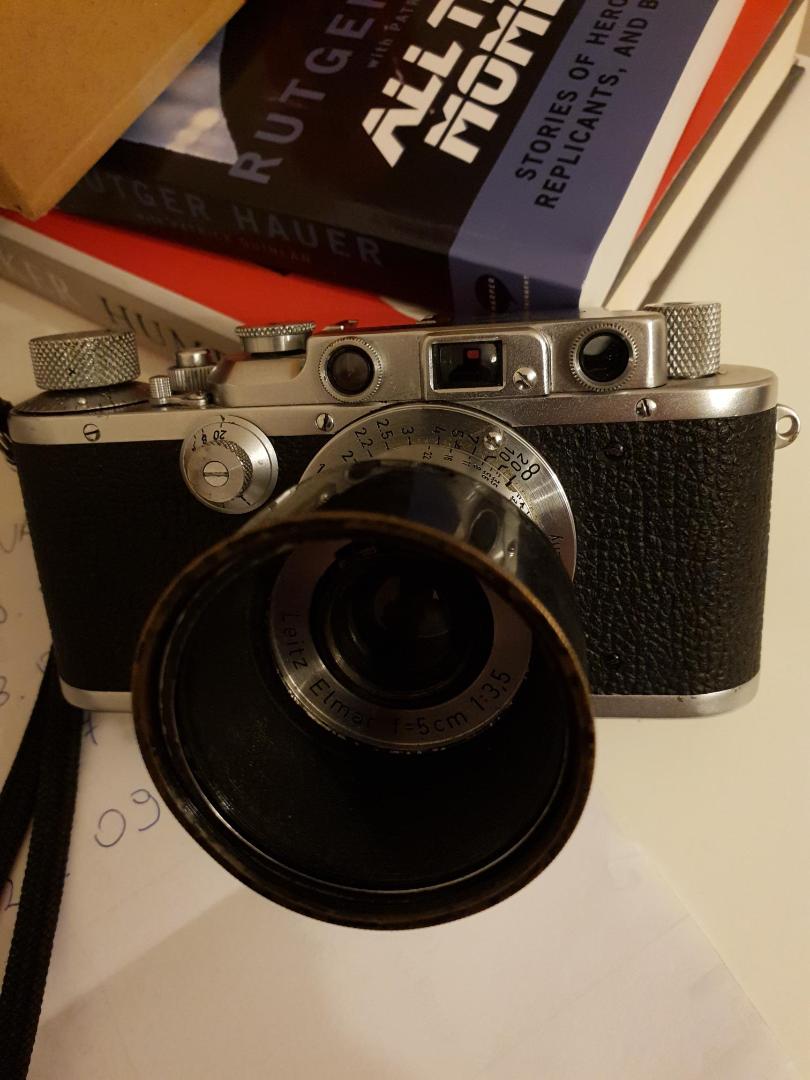

I got myself sun shade for LTM elmar 5cm f3.5, can I use this as well on Summar f2 lens?
Also ITOOY for Elmar M mount, can I use it on DR Summicron? The filter thread is the same, 39mm, but does bigger f stop need to have different (wider) sun shade?
Thanks!

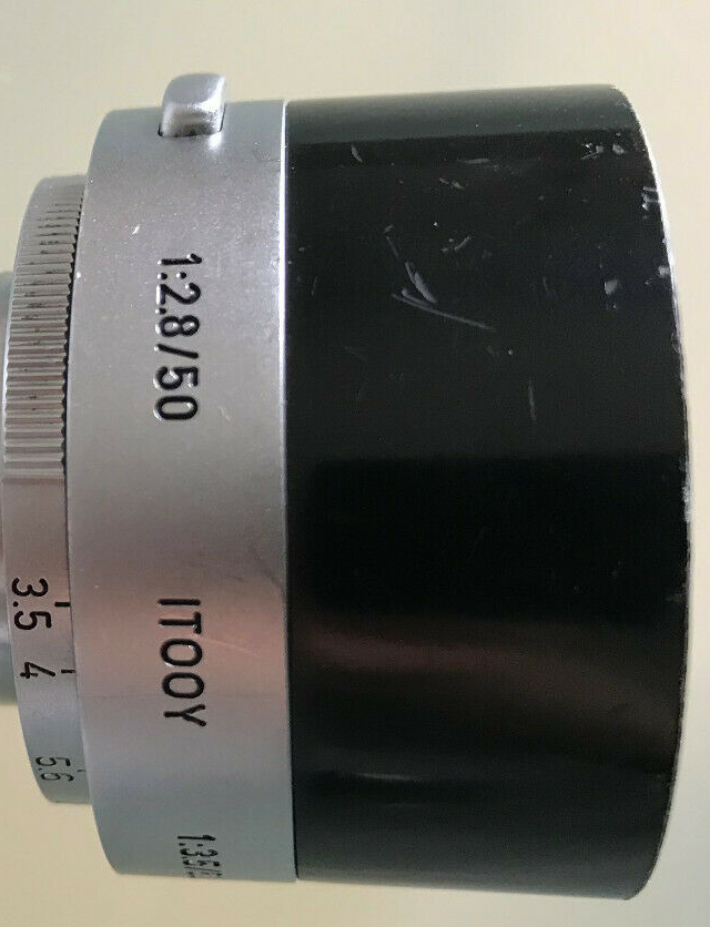

I can't speak authoritatively on the M-mount stuff but the FICUS(?) shade in the second pic works fine on my Summar 50/2.
I use that adjustable shade on the 90 and 135 as well.

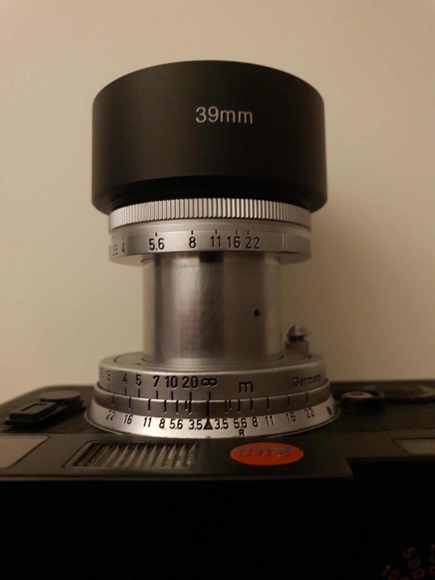

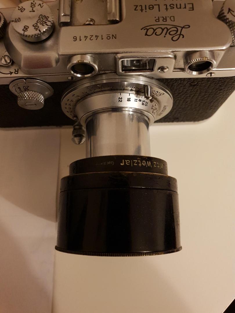

I did a test roll -- all is OK! Deep shade is ok for 50mm. It would be strange in any case that original Leitz sun shade does not fit to its dedicated lens.
Also I did a test of cheap Chinese 2 euros sun shade for 39mm M mount Elmar (similar depth, little shorter), and it is also ok:
