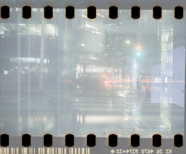

I often prefer to scan film including the sprocket holes, especially when the image bleeds over the perforations a little bit, as in this example:
The raw results from the scanner are usually very bland. Whenever I scan without perforations, I fix this by using Auto Tone/Contrast/Color in Photoshop, which is fast and gives acceptable results.
But when I scan with the perforations, using these commands does not work, probably because of the perforations throwing off the way the program perceives the image.

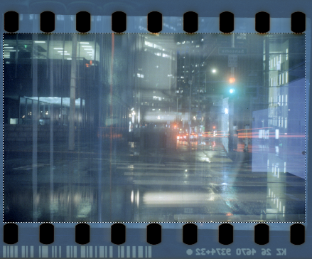

Inside the dotted selection, the correction provides a proper result:
However when applied to the whole scan (including perfs), the Auto commands do not produce a good result:

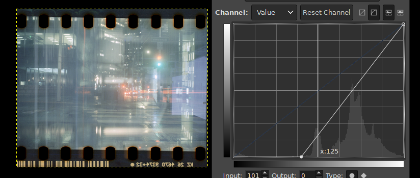

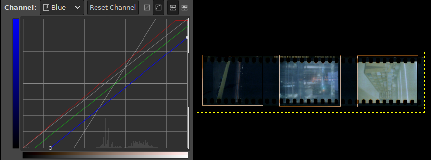

Automatically: no, I don't think so. Part of the reason is that there's no way a computer can guess your artistic intent.
I'd scan the entire roll with the same settings (i.e. no color adjustments done by scanner & scanning software) and then work out a curve (manually/by eye) that approximates what you want, and apply that to all frames. Then finish off by manually finetuning individual frames to taste.
For instance, an overall curve adjustment could look something like this:
Here, I assumed that you would want the film base to be barely visible, and I approximated the colors you seem to prefer for the middle frame. Such assumptions about your preferences are precisely why I think an automatic adjustment is likely to always fail; all it can do is balance everything out to an average middle grey.

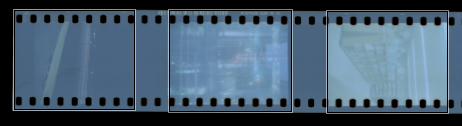

PS: the auto-adjustment may not be as bad as you think, but because it's thrown off by the large empty space, you could try and shifting the shadow point a bit to press down the film base deeper into the shadows, like so:
