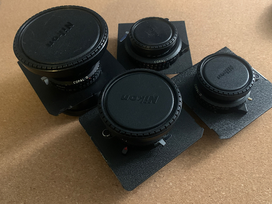

I’ve not used my Chamonix LF camera for a while and I’ve just found fungus in all four of my beloved Nikkor lenses 65 / 90 / 150 / 300
The fungus on the front and rear element wiped off easily, but there is some on the elements on the inside of each lens.
As these are seen relatively simple lenses, is this something I could clean myself with some care?
I thought I would ask before amateur attempts ended in disaster!

If the lens groups unscrew, you get access to the center surfaces. See what happens. This is a simple unscrew/screw assembly. No special tools. Pay attention for any shim washers, though.
If the fungus is on an inner surface, there are usually ways to disassemble the lenses and get access. Difficulty and tool needs are increased.

You can unscrew the cells to clean the inside surfaces. Also wipe the surfaces of the shutter (not the shutter or aperture blades) and of the lenses' housings to remove unseen spores.

SUCCESS! I had no idea it would be that simple. I have got rid of all the fungus, using a lens wipe / soft cloth / blower bush before reassembly. What a relief

I have to say it was really straightforward. Each lens comes apart in two sections either side of the mounting board (or whatever its called). It was only on these surfaces thankfully, so I wiped each lens element down and screwed it all back together.

When the fungus is "fresh" it is very easy to remove. If it lingers for a long time it might etch the coating. You should clean it with ammonia or Hydrogen peroxyde to make sure you've killed the fungus.
