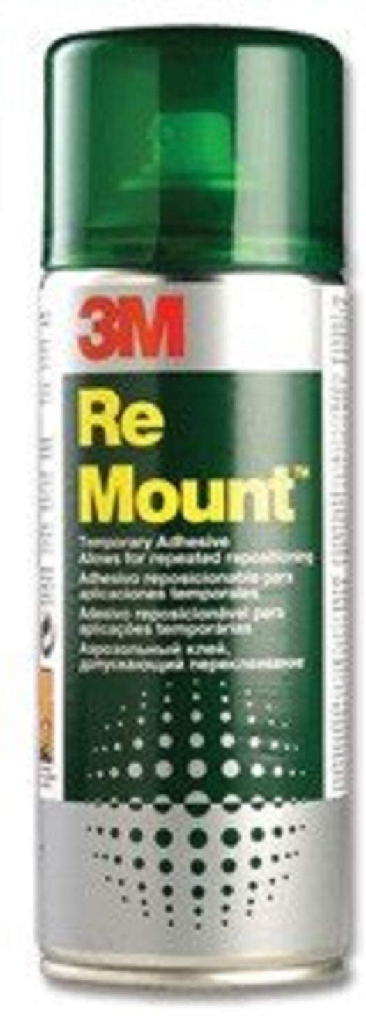

using a borderless easel and it was a bit of a pain to get it to lay flat.
You may use a sheet of mylar or similar plastic to address that, just spray the sheet (both sides) with 3M Re Mount glue, once dried it has a similar effect than the glue in a Post-it Note, so the mylar sheet placed on the easel will flatten the photopaper perfectly. The glue will remain in the sheet once you remove it from the easel. Not a pro way (vacuum easel is) but quite effective for home usage. After usage you may keep the glued sheet between two additional sheets.
