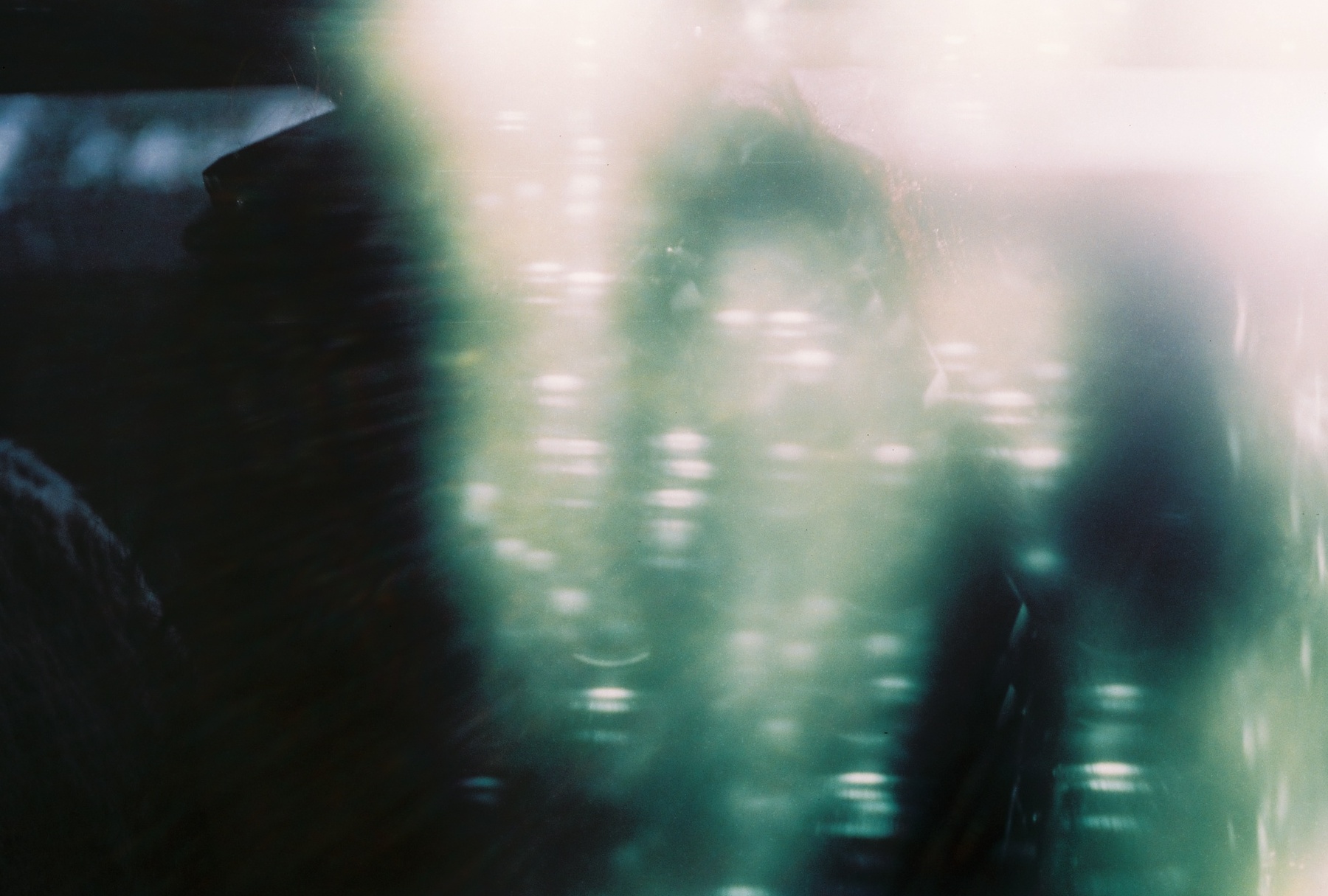

I recently bought a Zenit B and have just been playing around with it. My first roll came out fine, but the most recent negatives came out with these marks on it (see attachments). Not every photo came out like this and only one photo came out with the crazy what-appears-to-be-light-leak spread across the majority of the photo.
What do you think? Light leaks? Dust?
I don't particularly hate this new 'effect' but I don't want these marks to be on every future photos I take with the camera.
Thanks heaps!

SInce they are mostly at the top, and the pattern are similar in both frames, my first guess would be pinholes in the shutter curtain.

Does a Zenit have a cloth shutter? If so, I also think these are some pretty serious pinholes in the shutter curtain.
My theory is that the moment the mirror swings out of the way (and the curtains are still stationary) the "holes" are burned, and then, as the curatins start to accelerate, we see the "smearing" for a short time, until they move too fast to have an appreciable effect on the film anymore.

Though pinholes more typically appear in cloth shutters which are exposed to light (rangefinders, the second curtain of non-instant-return-mirror SLRs).
I've had pinholes in the past and they were usually "sharper". Anyway, *if* you can lift up the Zenit's mirror (carefully, gently!), look at both shutter curtains against the light. Even not lifting the mirror out of the way, you should be able to see something against very bright light.
My own candidate would be a more simple light leak... Are the film edges and sprocket holes also affected?

I just checked, the film edges and sprocket holes are not affected at all. Hm.
I can't check if there are pinholes as there is currently a film in the camera, but will do so as soon as I finish it.

You should remove the film now. If those pinholes are still there, they will affect any photos that you've taken on this roll and any future photos.
The best way to check this is to get a flash light and go into a darkened room. Open the camera back and remove the lens, lift the mirror and shine the light through the lens mount. Any pinholes in the shutter will be immediately visible.
I'm using a Crayola fabric marker to fill shutter pinholes. I like this product because it works and the shutter curtain remains very pliable.

Looks like light may be leaking around or through the bottom left part of the shutter, and in that corner spot on the upper left of the film gate. The more extreme example seems to follow the pattern of the less extreme example. Looks like there are four leaky spots, and the severity of the blobs depends on how long and in what light the camera sits between shots.

The longitudinal form of the artefacts in the right photo made me think they were caused by a leak in a moving shutter cloth passing a cone of strong light. But then they should only be seen in highlight areas.
Thus I guess they are produced as 2F/2F hinted at, statically by stray light in the mirror chamber entering through horizontal slit-like holes in the cutain cloth caused by one or two vertical threads ruptured.
