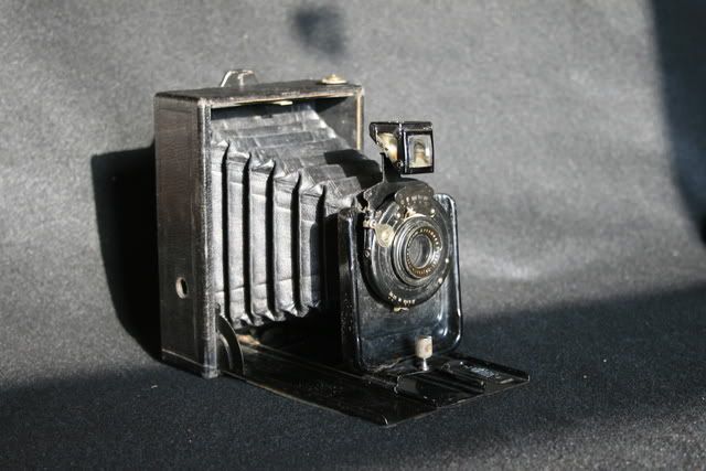

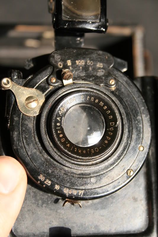

I got it for $10.00 the other day, but I don't know much about it...I was hoping you guys could tell me more. It says on the lens "Ernemann doppel objektiv" Everything works on the camera, it has O, Z, and has 1/100, 1/50 and 1/25 for shutter speeds.

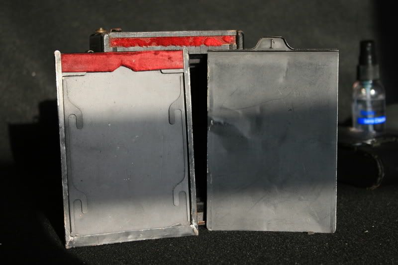

Looks like an old plate camera from the early 1900s, similar to the Zeiss Maximar and a few dozen other varieties. I'm not too familiar with holders, but yours might be a plate holder with a film insert which would let you shoot cut film (you might have to cut down 4x5 or something to fit it). Looks like the darkslide is kind of bent up though, maybe you can straighten it.

Yup, It's a plate camera from early last century. There are lots of them out there (I have three, and I wasn't even trying to collect them!) The plate holder you show doesn't seem to have the film insert - was there more? Do you have the ground glass back as well? If not, it may be possible to pick these things up; they often get orphaned. You don't indiocate the size of the camera or the focal length of the lens. It's most likely a 6.5 x 9 or a 6 x 9 (close to 2.5x3.5) or a 9x12. Film is available for either size and there are roll film backs that fit.
Now for the bad news: there are lots of different size/style backs, and you have to get the ones that fit. If Ole chimes in on this thread, he can tell you just about anything you want to know about this kind of camera -- he's been educating me for the past year or so. And check the plate camera sub-forum for (there was a url link here which no longer exists). You can pick up quite a bit through other people's questions.

The back is 4 1/2 X 3 1/2. And no there wasn't anything else that came with it. :sad:

There isn't much more I can say about this camera right now - maybe when I get home (next week?).
To guess at the correct type of holder (there are several almost identical but non-interchangeable types), I need to see the other side.

Addendum: 4 1/2" x 3 1/2" - that's probably 9x12cm. So the lens is probably a 135mm or 150mm. I don't have my library with me, so I don't know what kind of lens the Ernemann "Doppel-Objektiv Serie A" is, but I know I can find out.
The holder looks like it might be "Normalfalz", but it could be some other type.
I would guess at early 1920's for this camera, and for some reason the shutter looks to me like it could be a Koilos. "O" is "Offen", or "B"; "Z" is "Zeit", or "T"...

I looked up the lens in the Vade Mecum. The Doppel (the "Objektiv" part just means "lens") seems to be a doublet, as the name would suggest; the text says it dates "at least from 1902", is found in an f/11 version (which seems to be what you have) on something called a Simplex from 1926, and "was often the low cost option on cameras such as the Heag 0, 00, 1, 11 of the period".
It looks like the Simplex was a low-end 9x12 folder, which is what you have---I'm not sure whether it was an Ernemann model or existed only after Ernemann was assimilated by Zeiss.
These old folders are pretty fun cameras, but don't expect any miracles out of the lens. I think Freestyle is the only US source of 9x12 film. Plates turn up on eBay once in a blue moon, but to shoot film in it you'll need a sheath that fits inside the plate holder you have. In principle they'd be easy to fabricate out of sheet metal, but while it's obvious how to do that when you see one, I don't think it would be so easy without a model.
The different back formats are supremely complicated and are probably the main topic of discussion over on the plate camera forum. It looks to me like your camera can probably share holders and backs with Voigtlaenders. In my experience, the easiest way to accumulate film holders and backs is to lurk on eBay for dodgy cameras with good backs. And then there you are with a bunch of plate cameras...for good or ill.

If it is a 'Normal' 9x12, another solution is a spring back addition sold in the 50's and 60's to convert this type camera to 3.25x4.25. Has a built in ground glass, spring back and allows you to use standard 3x4 graphics Type V film holders. You can still get 3.25x4.25 film from freestyle. Look on the Bay.

Reunited with my library, I find that the Ernemann Doppel-Objektiv is what I should have suspected from the start: A Periskop.
That's a lens consisting of two elements symmetrically placed each side of a central stop. Since these are not achromatic, a small aperture is necessary to give satisfactory performance - the f:11 should have been clue enough for me: Wide angle lenses and Periskops were generally the only lenses to come with a max opening of f:11!
