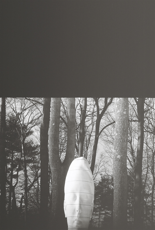

New to the forum here and enjoying the content! I recently inherited some LTM lenses (35mm, 50mm and 90mm). I've been using them on my Sony NEX, however they made me really want to get back into film. I purchased a Canon 7 rangefinder of the web. The seller listed it as untested, but indicated that the shutter speeds seem to be accurate and the rangefinder was properly set. For $100 USD, I decided it was worth the gamble. However, upon testing, of course I realized a few problems:
  1. see the picture below. I feel like this is a problem with the film not advancing, as the statue is meant to be centered in the frame:
  2. Typically about halfway through the roll, the exposure counter stops advancing. It turns halfway to the next frame, then clicks back.
I feel like the take up spool is not working properly. It's really difficult to load as the little tab in the spool that catches the sprocket hole doesn't seem to grab the film properly. Is it possible that it is losing it's grip halfway through the roll and the extra slack is not allowing the film to advance?

Good Evening, RallyFan,
It could be a problem with the focal plane shutter. Wild thought: Any chance this was shot with on-camera flash? This looks somewhat like a flash shot made at faster-than-sync speed, although the complete lack of detail in the upper portion of the picture isn't typical of that problem.

Konical - This was not shot with flash (doesn't even have a hotshoe!). A little more than half of the pictures came out properly, and a handful ended up like this.
I'm really hoping this is salvageable, I love the size, viewfinder, and the fact it gives me both 35mm and 50mm framelines. Otherwise, I may have to bite the bullet and get a Leica III.
Good Evening Again, RallyFan,
I can't think of anything besides a malfunctioning focal-plane shutter. You might test at various speeds to see if the results are constant.

I did buy a few rolls of expired film for cheap and ran it through the camera both with the back open, and with the lens off so I could watch the shutter. Tried all the different speeds and didn't notice anything out of the ordinary. I might try it again a few times.
