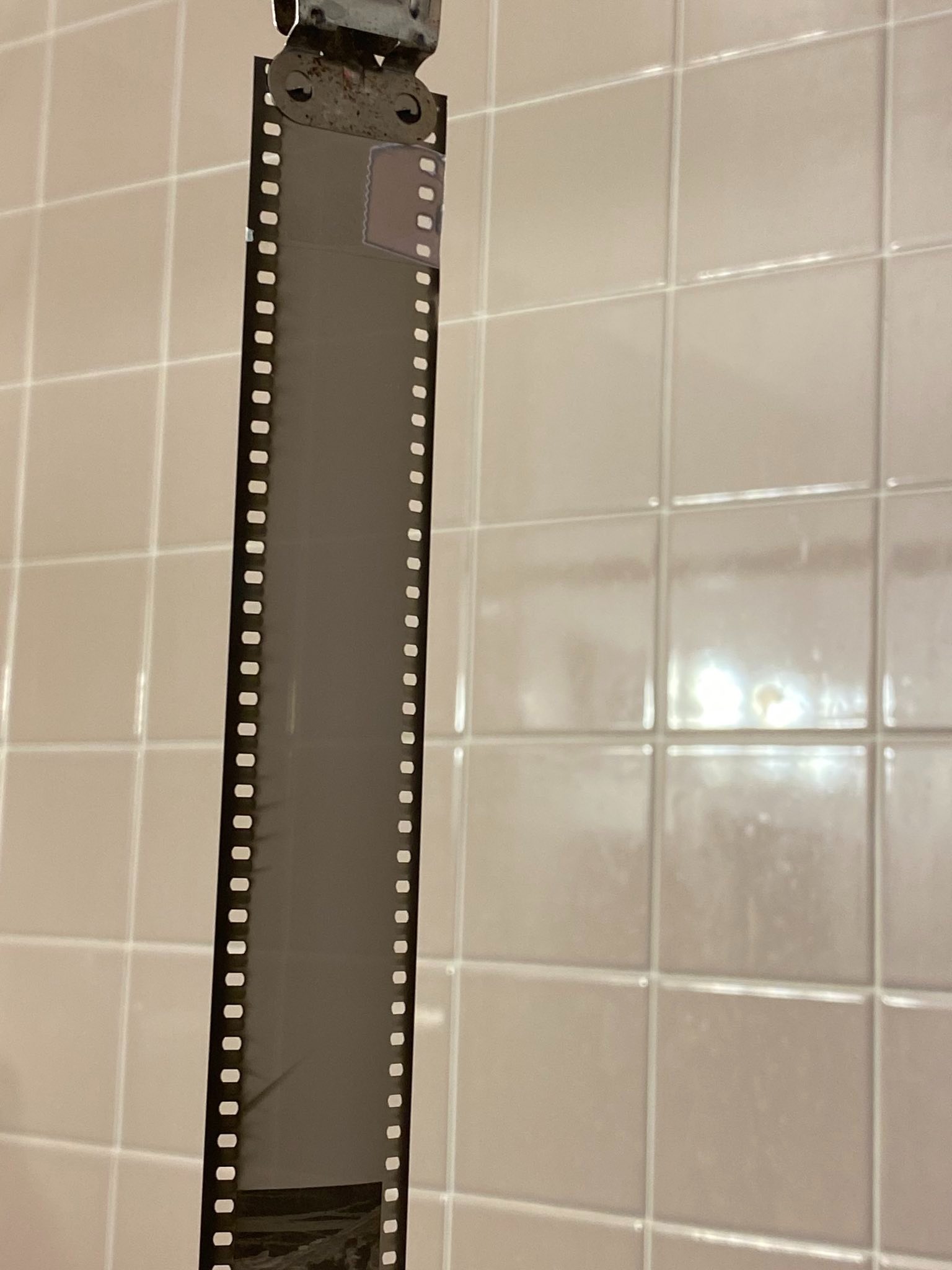

I bought a batch of Double-X rolled into recycled 35mm metal cassettes from an individual. Just developed 2 tonight. One came out fine and the other is showing light intrusion around the sprocket holes, that occasionally goes into the image area. This light intrusion is very consistent from beginning to end of the roll, so I'm thinking it happened in the bulk loading process rather than when it was all in its cassette. Here is the picture of the end of the affected roll.

I don’t know for sure, but it looks like the reseller’s bulk roll was opened with the lights on. Light appears to be leaking from both sides to a regular depth, plus the occasional stray beam where the layers of film weren’t in perfect contact.

Yup. That is edge fogging.
Double X is a motion picture film; note the B&H barrel perforations. He's probably selling from short ends that have been recanned on set. It's not hard to edge fog the film in the heat of the shoot!

Could be the cassette too, the spool end might not be light tight, or the end cap.

I thought about that, but in cases where that has happened to me, the start of the film has a lot more leaking than the end. This is very consistent from start to end of roll.

It is possible that the roll had been opened somewhere and seen light. If it is not exposed for too long the inner side would survive but the edge would be 100% cooked.

The light on your film has penetrated the area around the sprocket holes, mostly. Given the fact that the fogging is similar on both edges, it seems the roll was exposed to normal room light or even daylight, and exposure was fairly through - i.e., they took their sweet time having a look at the roll. It's to be expected that the fogging pattern will be similar across the entire 400ft roll. The leader of the roll would have been entirely fogged, including the image area. This will be true for the outer few layers of film. It's likely that the fog will protrude a little less into the image area on some parts of the film, but I don't expect any of this film to be unaffected.
The film you have is basically FUBAR. Too bad! It's best to purchase cine film directly from reputable sellers. I get mine from frame24.co.uk; I think in the US, there are more choices.
