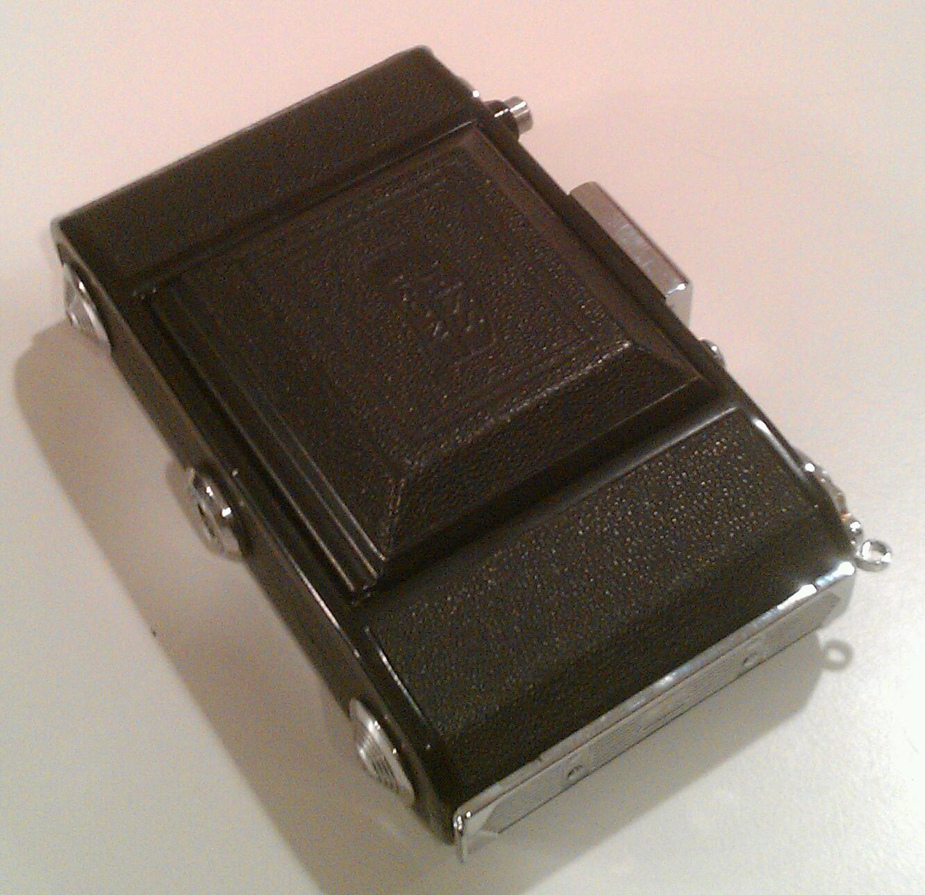

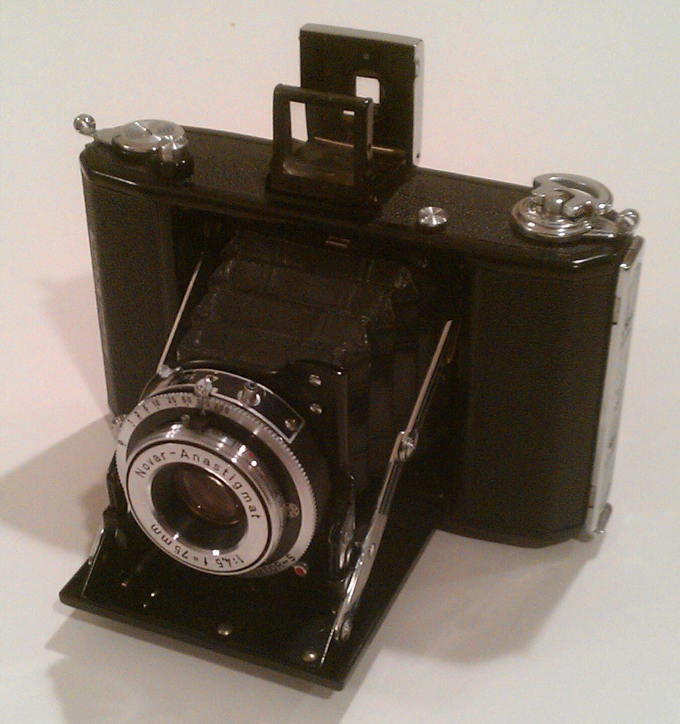

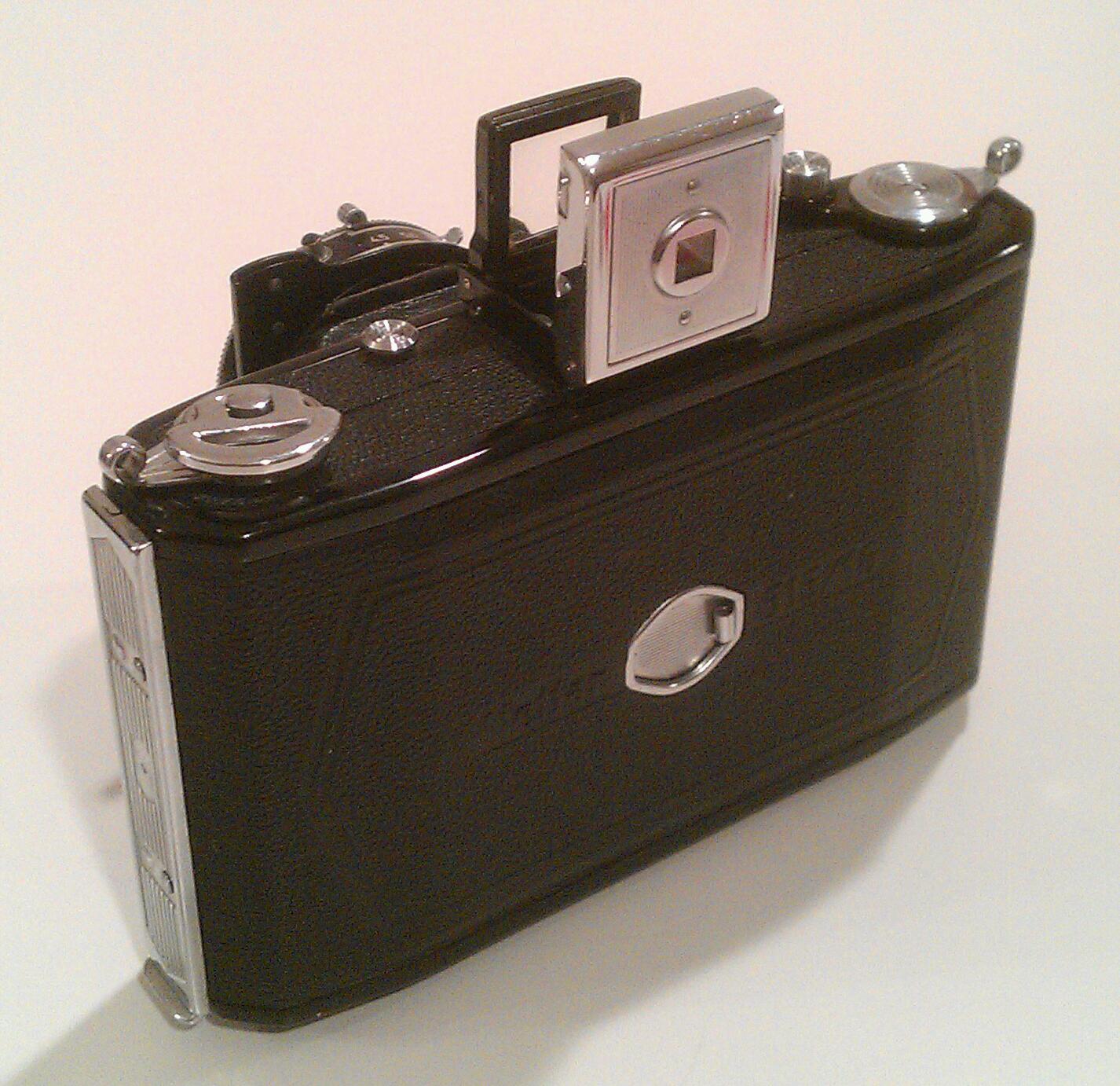

Once I got a few issues sorted out on my Zeiss Nettar 515/16 (6x6 format), it is pretty decent. It doesn't match my Rollei 3.5F, though.
Issues I had were a reversed lens element and then a pressure plate not exerting enough pressure. I also realized the lens' sweet spot was not f/5.6 or 8, but rather 11 or 16. That, and holding it steady - it's too light!
The Nettar is second to the Ikontas though.
