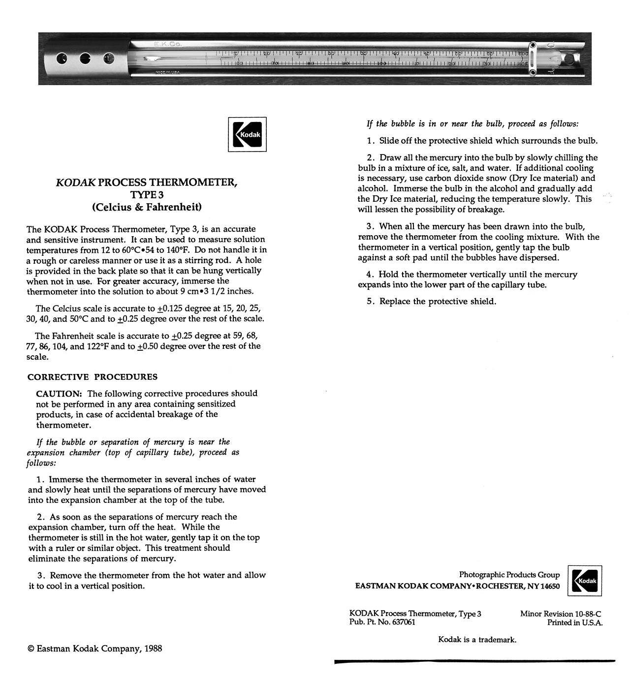

Here are the instructions for the Kodak Type 3 Process thermometer (the mercury version), with advice on how to fix column separation.
This is the thermometer that is used as my darkroom standard. I even calibrate my Hass Intellifaucet against it. It's a beautiful instrument.

Column separation is the only problem that can occur.
I didn't mention another problem as it is rather rare. There is a small chamber or expansion spacer at the top of most thermometers. I have had liquid become trapped here. Some might lump this with column separation but it is not quite the same and results in a different error from true column separation. The thermometer will read lower than the actual temperature.
I took a closer look at the thermometer last night and as you probably would have guessed there was a break, some fluid was stuck up at the very top of the tube. I heated it up and reconnected that bit, now it is as it should be. Thank you everyone.
