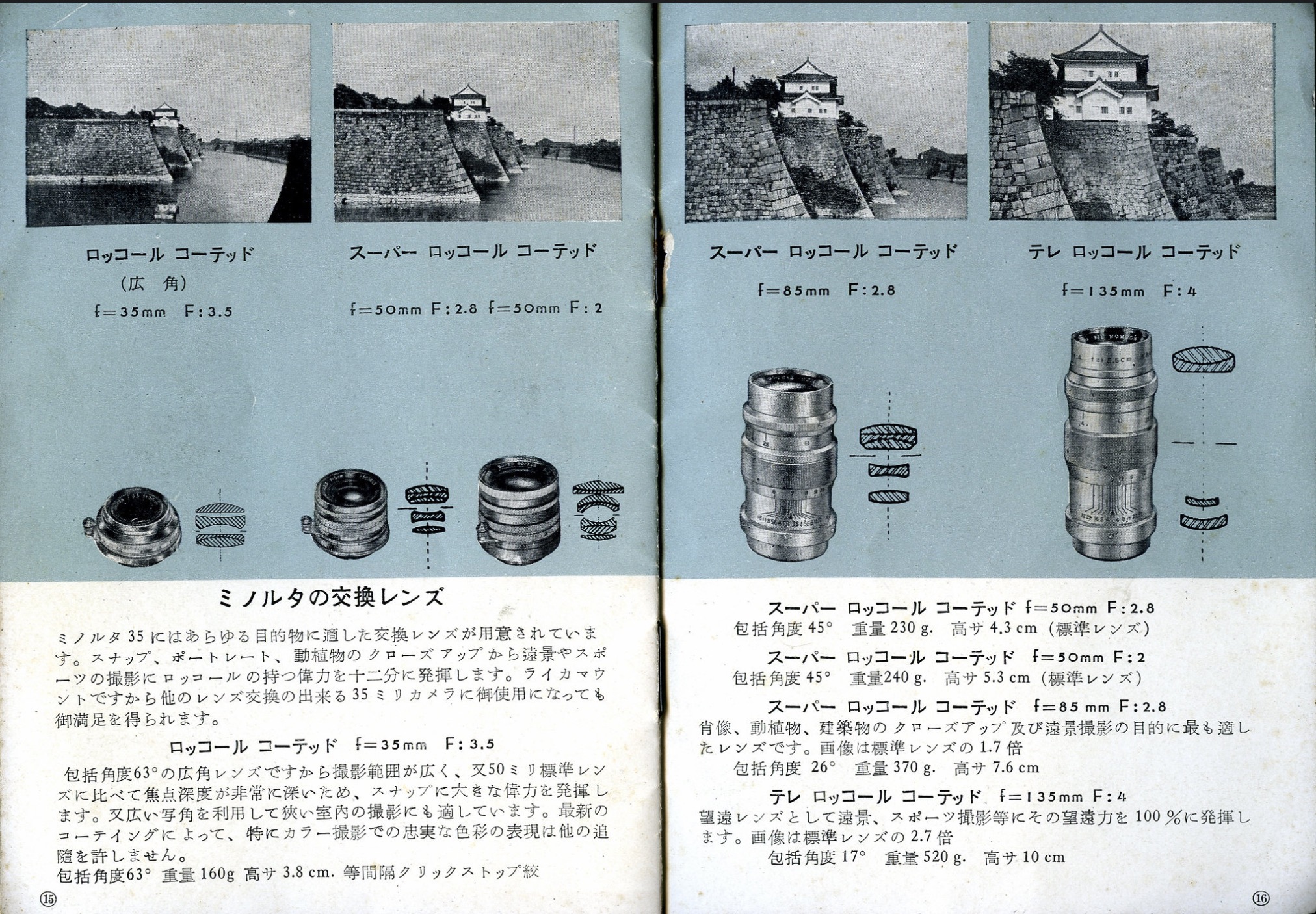

I do not believe this is accurate. In Minolta's brochure it is shown as a lens with cemented elements.
Also, if the elements in the Super-Rokkor 5cm f/2 were in fact air spaced and not cemented, why would it often be referred to as "close to the Summitar" and not "close to the Summicron" (collapsible version) which has air spaced elements in the same configuration?

If you look closely at the diagram from Minolta in the link, you see a Black line for the two air-spaced doublets and a white line for the cemented rear doublet. You also will note that I bought one and took it apart.
The rendering of the Minolta lens is much closer to the Summitar than it is the Summicron. The Summicron used high index of refraction/ low dispersion glass. The original version uses Thoriated glass.
Minolta, wide-open. "Swirlies" like the Summitar.
"Lens Groups are defined as being cemented, air-spaced, and oil-spaced. The Minolta Chiyoko 5cm F2 is a 2-2-2-1: 7 element in 4 groups. The 1st and 2nd doublet are air-spaced groups, the doublet behind the aperture is cemented. Air-spaced doublets allow 4 radii to be used for better control of spherical aberration. As this lens was always coated, the designers apparently felt the extra degree of freedom was worth the extra air/glass interfaces. A second reason to use air-spaced (and oil spaced) groups is to accommodate different coefficients of expansion of glass elements used in the group."
As to the brochure you posted- note the heavy black lines for the two front doublets, and the thin line for the rear doublet. Minolta is showing the air-spacing between the elements, but 70 years later- unless you take one apart you will not know why they did this.

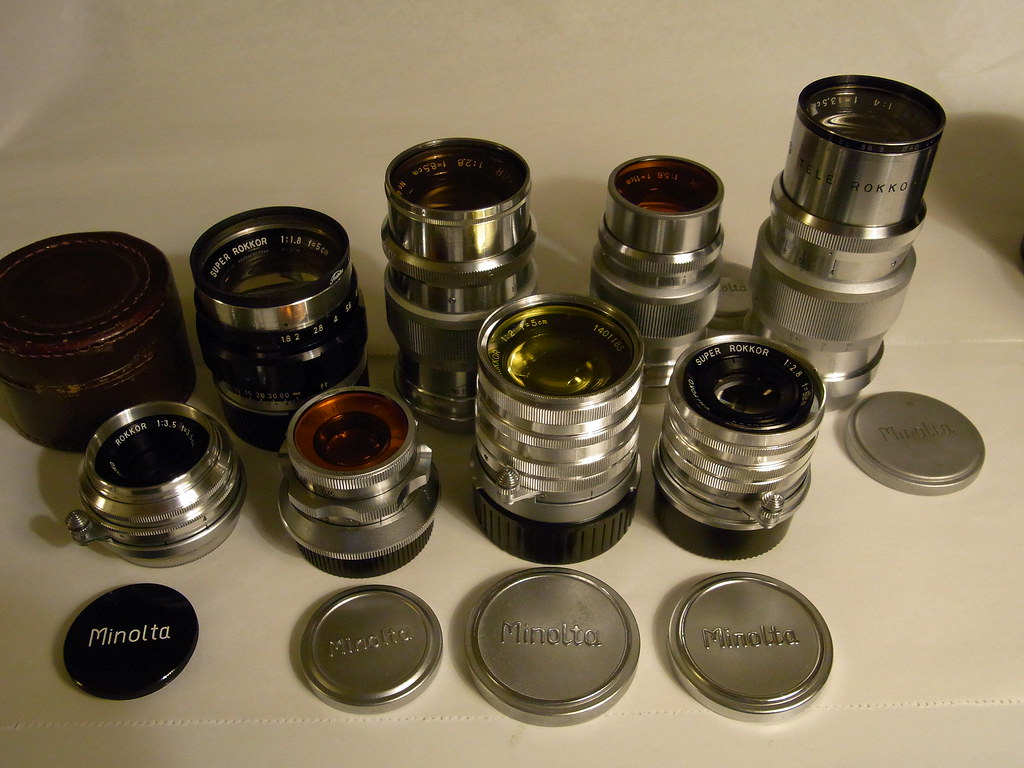

Minolta_Chiyoko_Collection by fiftyonepointsix, on Flickr
The more common 5cm F2 that uses 43mm filters shown in this picture.

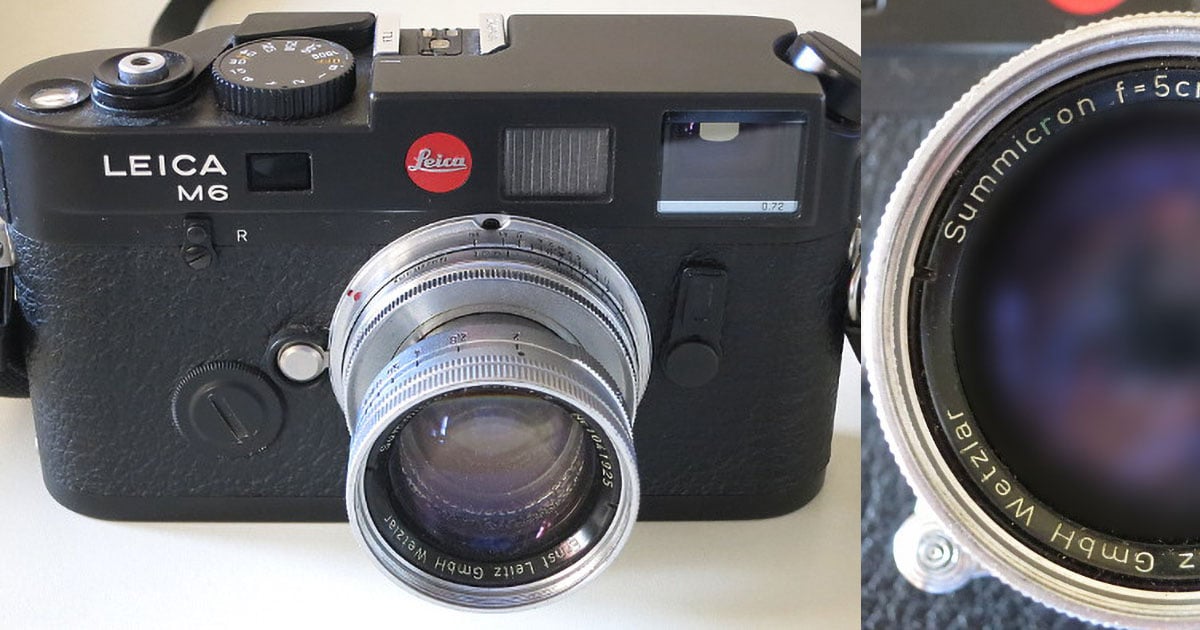

Note that the element that Matt polished is radioactive- primarily an Alpha emitter. I would not polish this element by hand, given the danger of ingesting the generated dust.
The Summitar- not radioactive. This version of the Summicron: the front element is radioactive.
Matt's lens is #1021080 which is well after the book stops on radioactive glass at #922072 although there are reports of outliers presumably as Leica used up older lens elements ad hoc as was usual.
I currently have a Radioactive lens in the 104 block and one in the 995 block, and have had two others. These are Thoriated lenses, I cleared the Yellow front element using a UV lamp. Sunlight works, but also dries out the lubricants. The 105 block is safe. I do not know where the "922" number came from, it is wrong based on my first hand experience.
