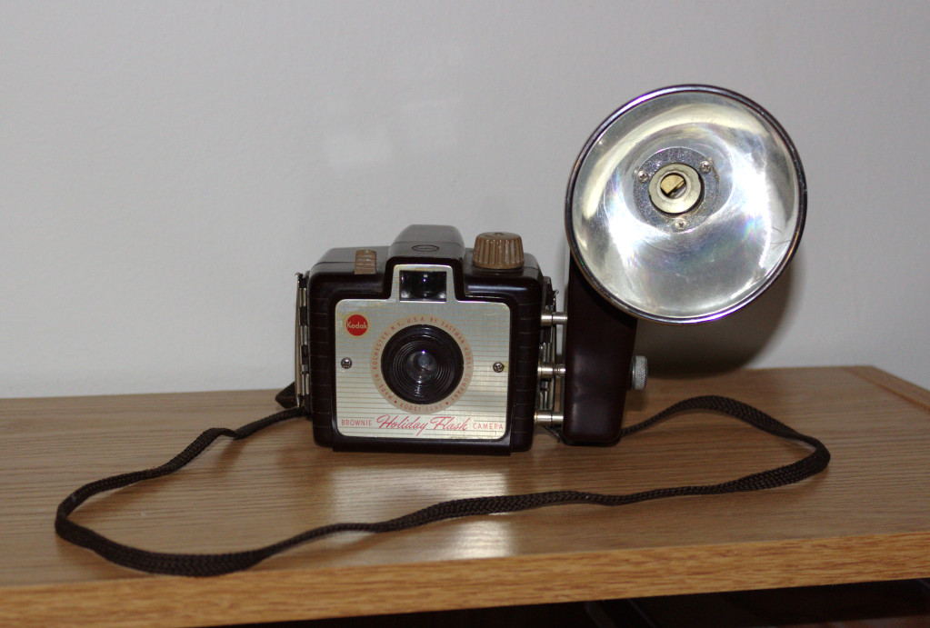

I was just thinking.... Would it be possible to rig a Vivitar 283 flash unit to a Brownie Holiday Flash camera? I searched around the net and didn't find anything.

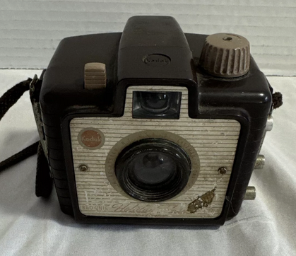

I think there are a lot of different Brownies. I wonder which one the OP was talking about?
Don_ih
Jan 24, 2021
7,741
Ontario
Likely this one:
since he said it was a Holiday Flash (photo borrowed from an ebay listing)
