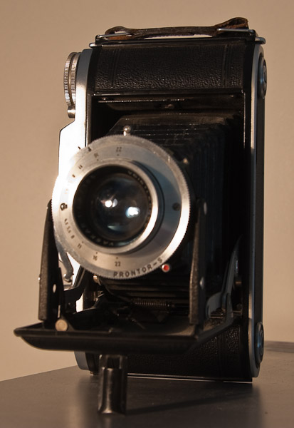

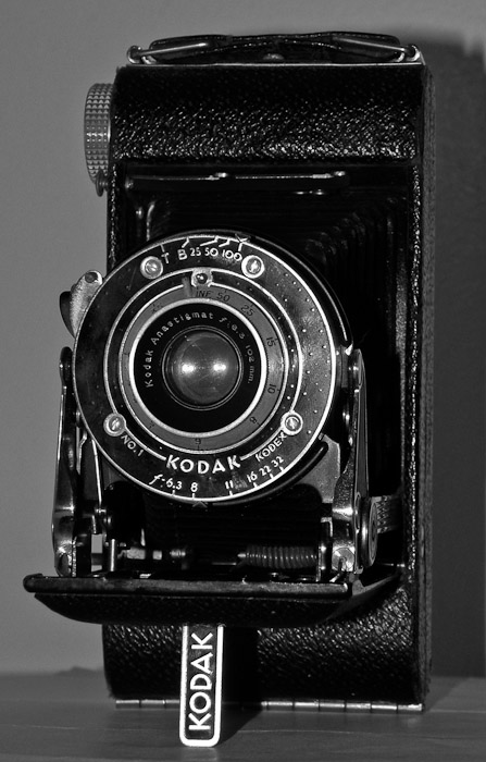

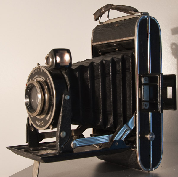

the 6x9 foto's are three I have but the Kodak takes 620 film beware make the 6x9 takes 120 roll film:
