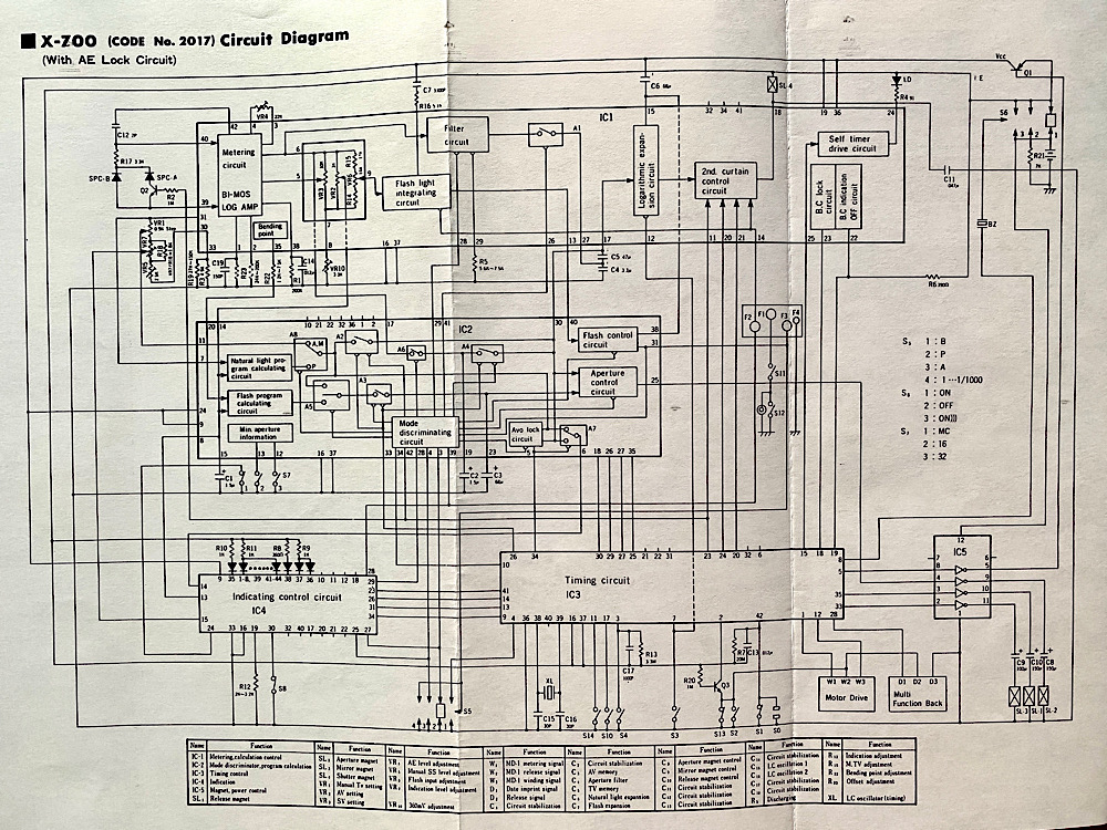

I've got a Minolta X-700 I've been working on that had needed a new charging lever gear/shaft and is now ready to start adjusting the shutter speeds.

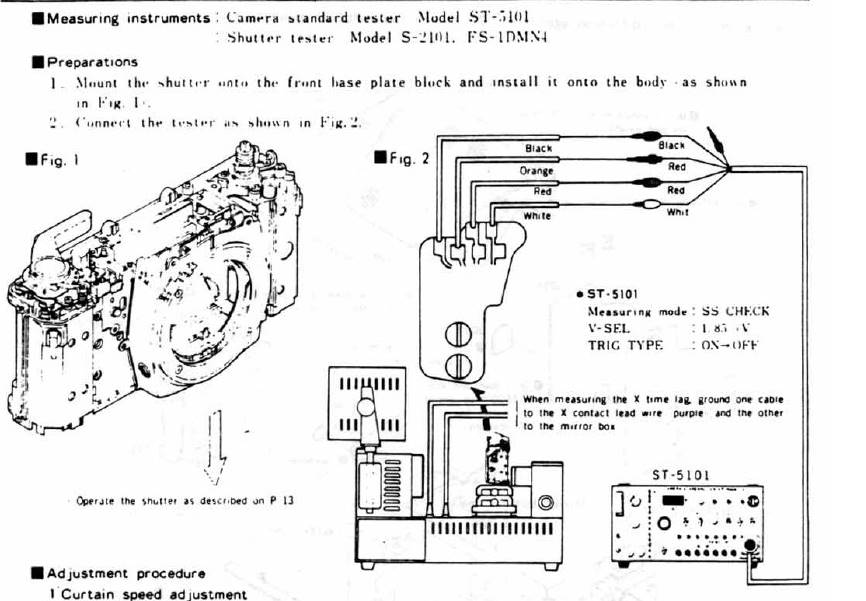

The problem is, while I have an oscilloscope to actually measure the shutters, the manual only describes using a discontinued piece of hardware (ST-5101) for actually firing the shutter to check the curtains. It doesn't say what the output of the tester looks like, just how to connect it.
I was wondering if anyone had one of these machines or even a manual I could reference the output for and program an arduino to do the same?

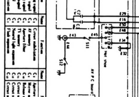

Also, the manual I have for the Minolta, a PDF scanning, was done pretty poorly and left most of the text in the circuit diagram illegible. Don't know if any of you folks would happen to have a hard-copy of the manual circuit diagrams you'd be willing to grab a few high-res photos/scans of?

This and other measuring devices were most likely only used by Minolta in their own service facilities and are therefore no longer available, see

Hey Andreas!
I've been getting good measurements of the shutters with an oscilloscope and a 3-sensor light detector setup, but I'm having some trouble getting the camera to trigger with the board removed as it needs to be off to reach the curtain tensioners.
Then I need to sort out an issue with the slow-speeds timing out (the 5s Low-Speed Limitation). Installed all new caps, but I can't read the lettering on the schematic so it's difficult to see which pin/components are which :/

Then I need to sort out an issue with the slow-speeds timing out (the 5s Low-Speed LimitaInstalled all new caps, but I can't read the lettering on the schematic so it's difficult to see which pin/components are which :/
I have the service manual for the X-700 as a hard copy, I'll check if the quality is better there.

I have two more circuit diagrams, this one should be the most recent one and corresponds to the version you showed.
I'll send you a link to my Dropbox via PM for the higher resolution version.

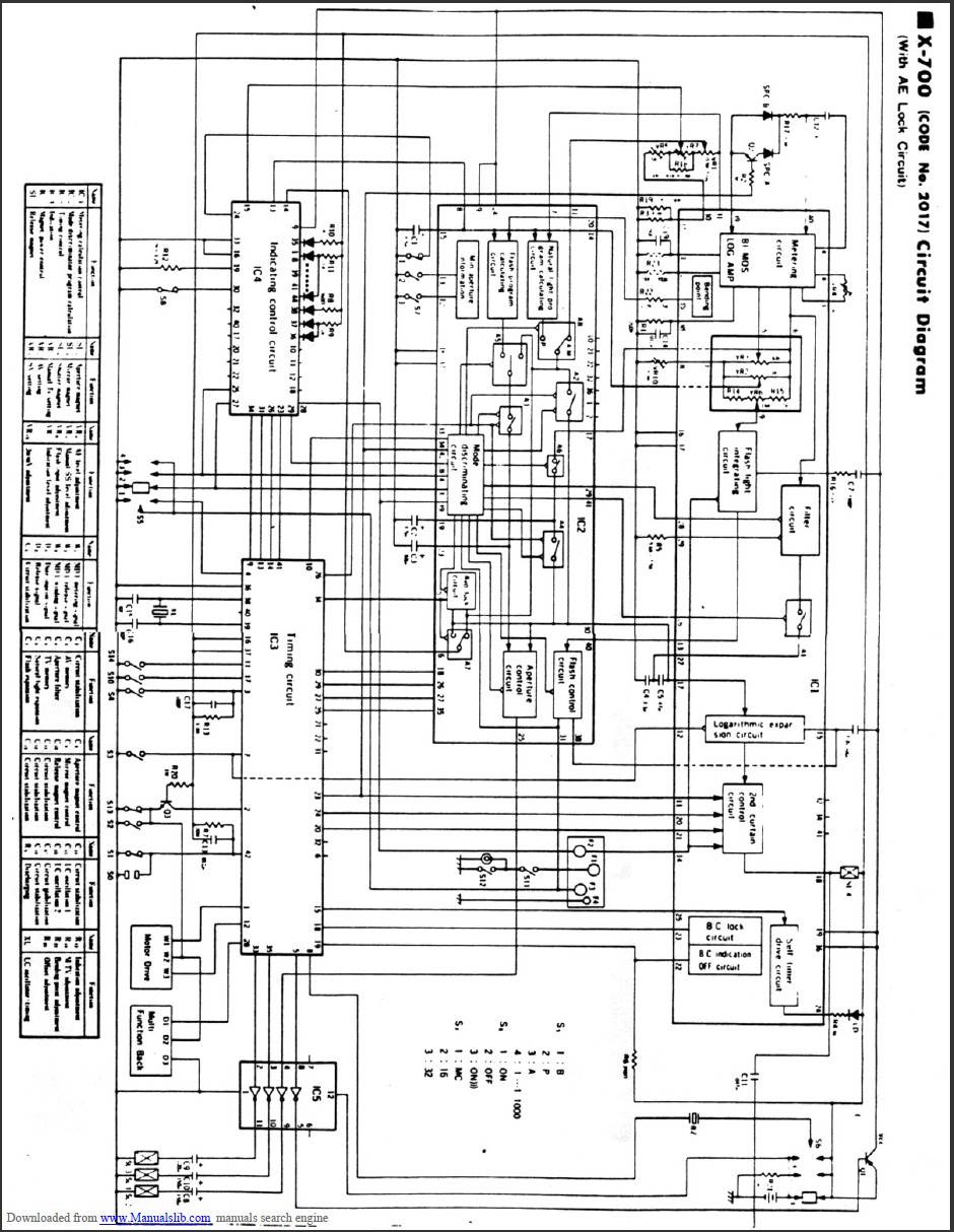

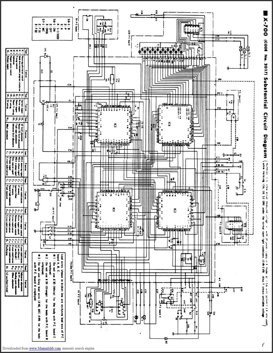

Oh wow, that is a lot clearer! There's a few other schematics and a couple tables that aren't legible in my copy (The version from LearnCameraRepair). I just uploaded my PDF manual here: Minolta-X-700-Service-Manual.pdf
View attachment 367727View attachment 367728
I need to get a hard-copy myself and scan it. Don't feel right asking you to take dozens of photos for myself. There's a reprint on E-Bay for $60 which is kind of a chunk of change if I don't know if I'll be able to get the camera going (That Low-Speed Limitation...), but I suppose I could relist it when I'm done.
I will ad these pages to my Dropbox in higher resolution.

I'm currently stuck on adjusting my curtain speeds, however. The manual says to adjust the tension on the curtain springs until both curtains are "11ms" (+/-0.3ms), however, it still wants that done with the shutter tester. The problem is I don't know what the reference range for 11ms is? Is that the time it takes a curtain to move from one side of the slot to the other? Right on the edge or 35mm? 34mm? 36mm?
Any good writeups on testing curtain speed? I have a little sensor I made to work with my oscilloscope (3 sensors, one on the left, right, and center), however the outer sensors are only 30mm apart as that was the pitch for the PCB holes.
