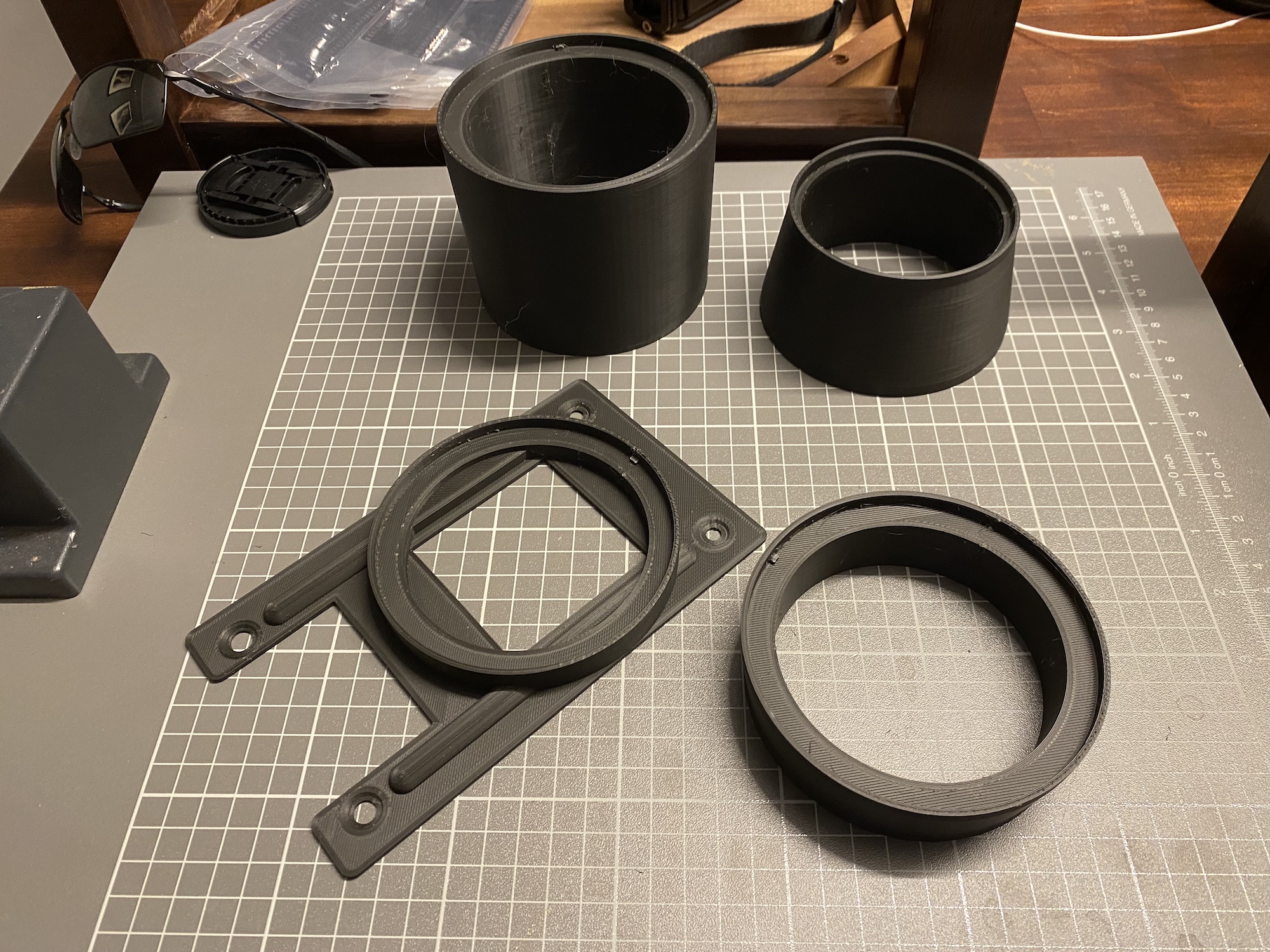

I use a Sony A7RII and Sigma 105 Macro to camera scan my film. I used a reproduction stand from Kaiser to hold the camera and I tried a few different film holders but I always was really put off by the complexity.
Put the film in, place it on the light board, place the light board on the repro stand (so far easy). Then put the camera on the stand and adjust it perfectly parallel to the base board. Left-right adjustment is not a big problem, but the up-down adjustment never was possible. The arm of the stand will bend a bit under the weight of the camera.
Then you need to find the perfect distance, place the film holder accurately, darken the room to prevent stray light from hitting the lens, take your shot, move to the next frame. The moving to the next frame almost inevitably also moves the film holder a bit, so you need to place it again.
I HATED it.
I bought an EFH (Essential Film Holder) from Andrew Clifforth in the UK and since I also own a 3d printer, I thought about another solution:
A base plate that fits perfectly on the EFH. Then distance rings of different sizes. And finally a top in the size of the lens hood. So now the positioning is easy. The distance is fixed and always correct, the camera is always placed perfectly parallel to the film holder in the exactly right position. I still use the stand but only to tie the camera to in case I knock it over.
Here you see a 35 mm frame, fitting perfectly in the camera display:
I use different rings to enlarge the distance to scan 120 film.
If you also own an EFH and have access to a 3d printer, find the design in Thingiverse:
I have made many different ring sizes and top diameters so that it should fit almost every macro lens.
You need to log in at thingiverse first, otherwise the link might not work. If it still does not work, search for "Camera stand for EFH Essential Film Holder for digitalization of negative and slide film"
Under the files there you will also find a file called "description.pdf". Read this to understand how to pick the right tops and extension rings.

That looks very cool! When I get my setup going I’ll give this a try.
