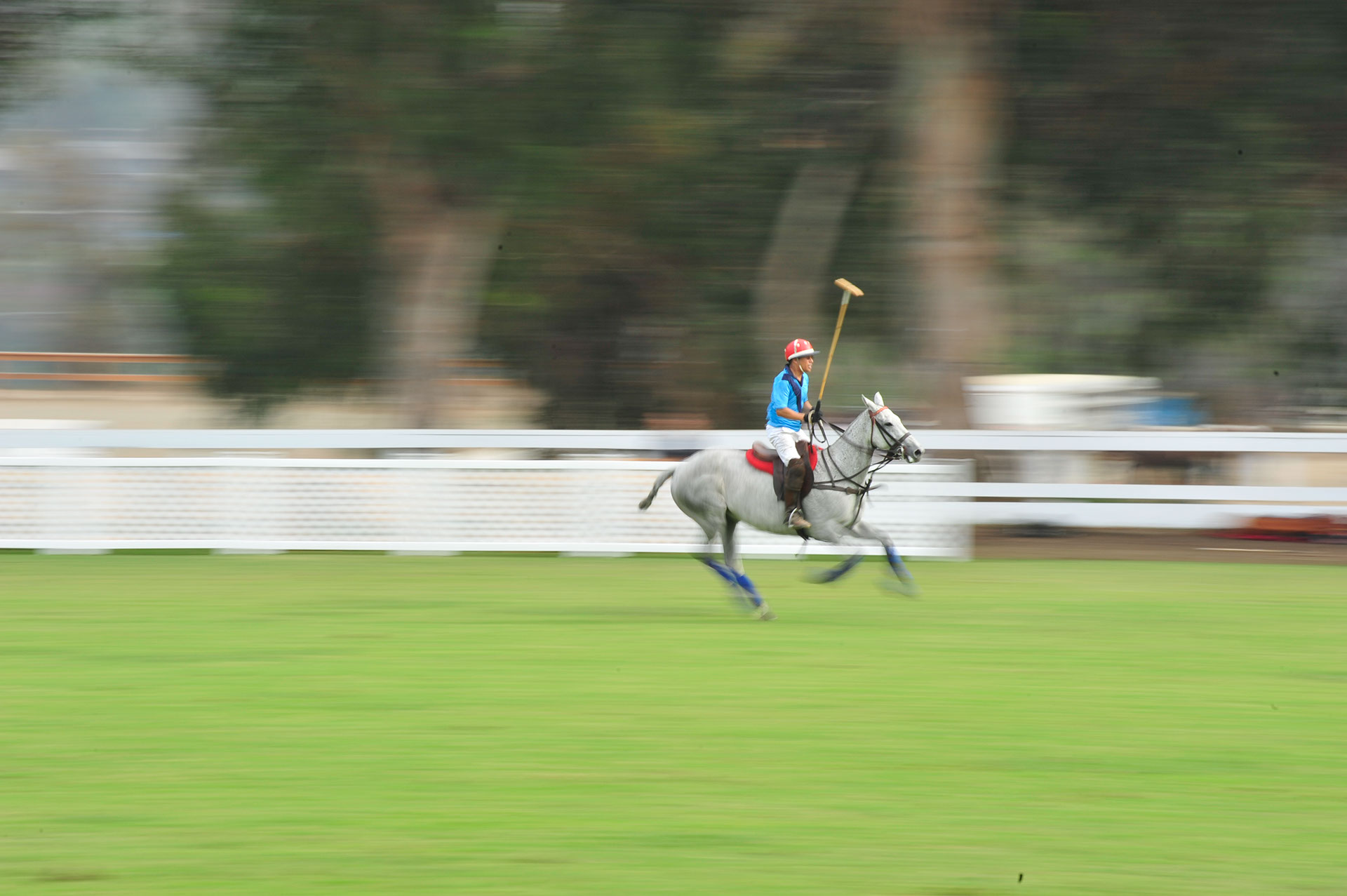

Super8
Not sure what you are trying to do but for objects in motion, use a slow shutter speed (1/30th or slower for example, it really depends on the relative direction of travel and the focal length of the lens) and panning with the moving subject to keep the subject in the same position in the viewfinder. Takes some practice--I would suggest practicing taking photos of cars in traffic using a digital camera to refine your technique for the effect you want. Of course if you want the subject to have some motion blur and the background sharp, still use a slow sutter speed and hold the camera steady or on a tripod.
Pieter12
Aug 20, 2017
7,617
Magrathean's computer
Super8
Forgot to post an example:
