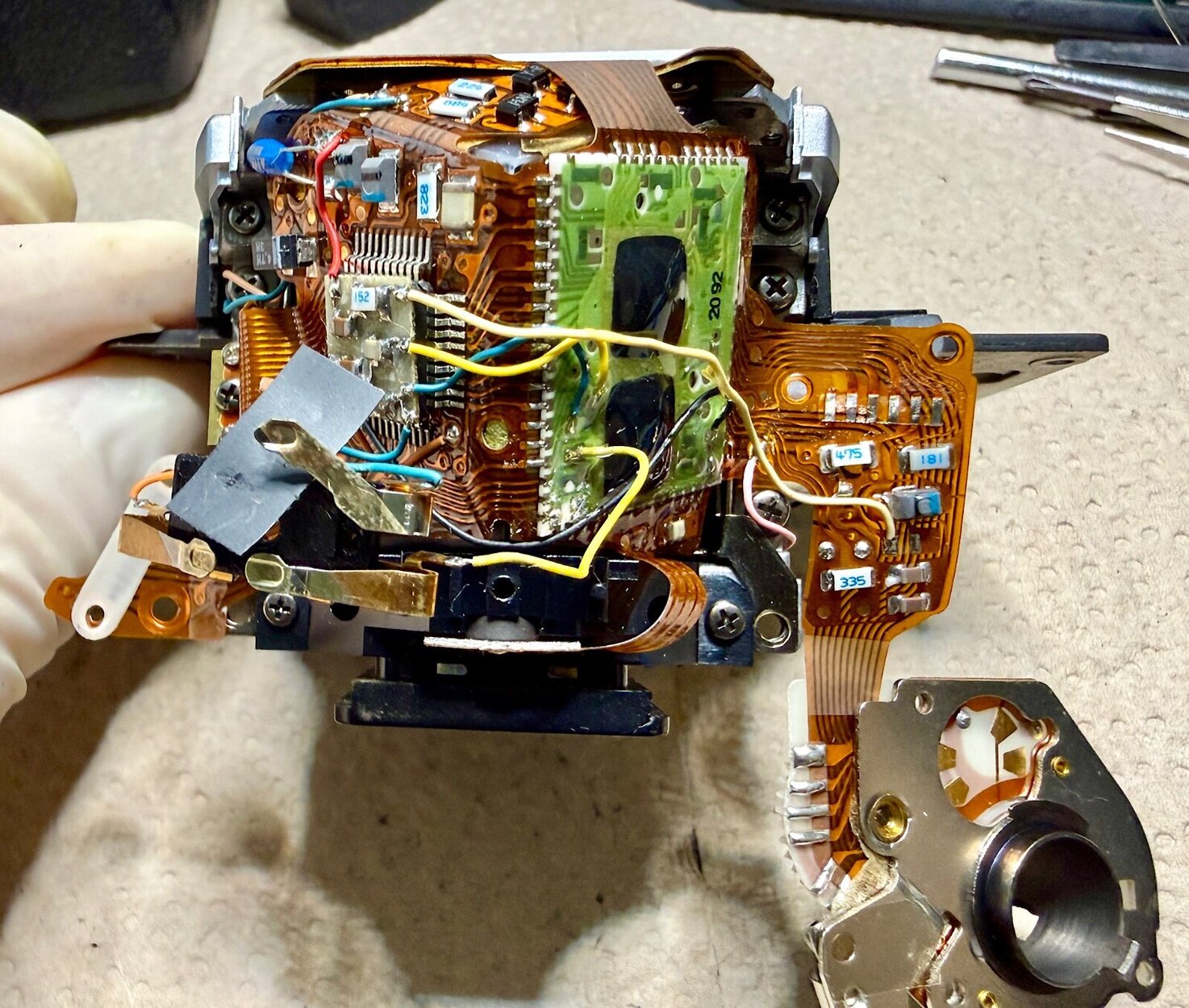

Nikon FG: Mirror box, top. Wind side HIC, rewind side I2L IC.
Circuit boards, ICs, discrete electronic components, small circuit boards with sub circuits like DC/DC converters, cables, motors …

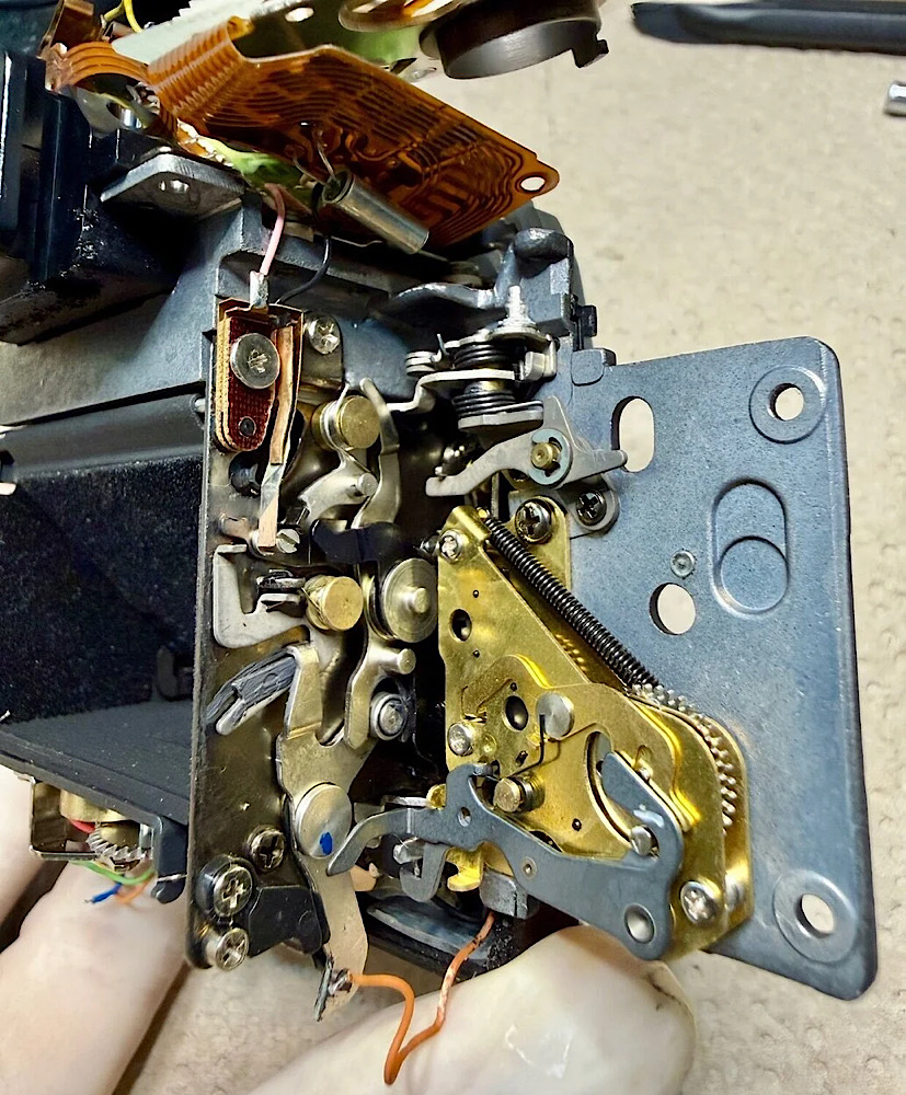

Nikon FG: Mirror box, wind side with mirror mechanism, release-plate assembly and self-timer mechanism.
… sturdy mirror box mechanisms, shafts and gears.

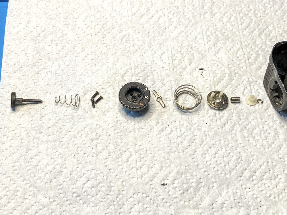

Nikon MD-4 Motor Drive for Nikon F3: shutter release mechanism combined with mode dial.
And incredibly intricate assemblies like the shutter release mechanism combined with mode dial in the Nikon MD-4 Motor Drive, which consists of numerous individual parts that you have to assemble using two springs, much like a jigsaw puzzle.
