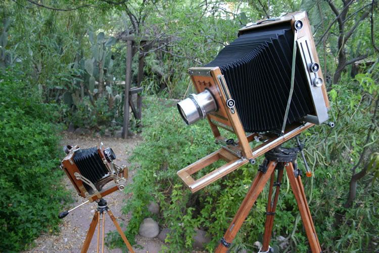

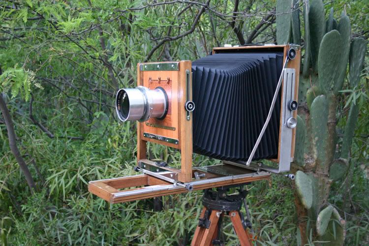

I really like the look of the refinished B&J cameras. When I was looking for an 11x14, the B&J was my first choice because of its 9" square lens board, but I knew I'd end up refinishing it. Fortunately, one turned up a few months ago that was already done! And it looks just right on the Ries maple tripod...
I'm considering having the aluminum black anodized, but I'm not sure how well it would hold up in the field...
