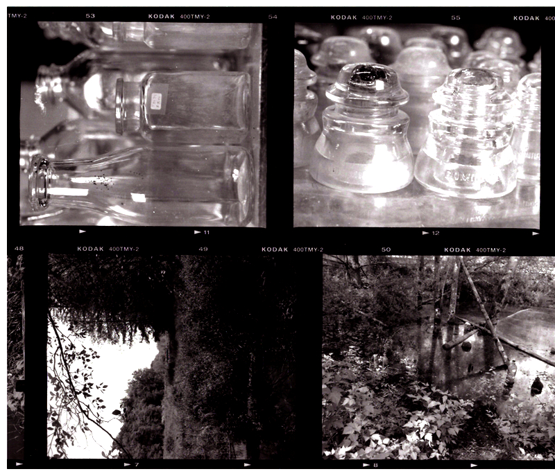

Position it the way that makes most sense for the final print.
I also make contact proof sheets of the entire roll, and store it with the negatives.
Something like this excerpt - of some 6x7 negatives in this case:
