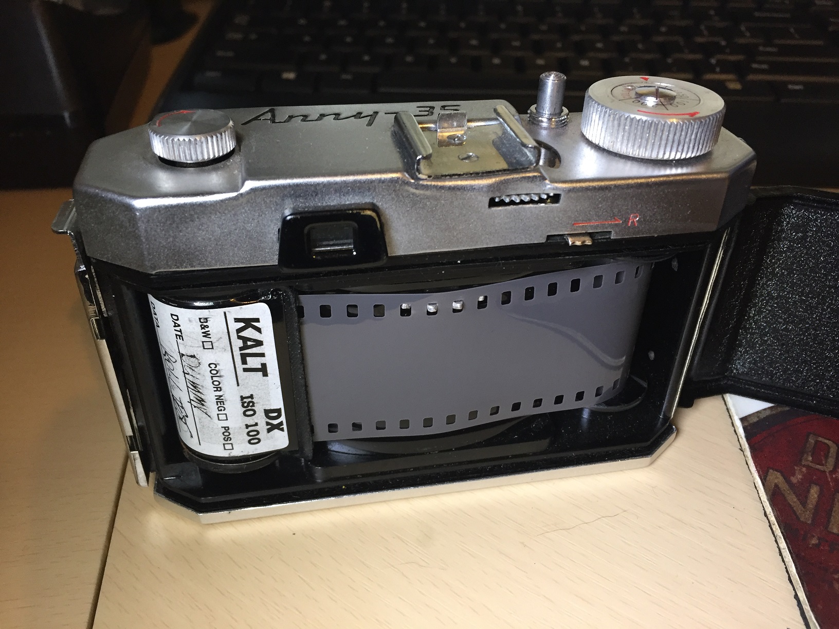

The Howay Anny-35 can easily be used in this fashion. The shutter is uncoupled from the frame counter, which is a simple film sprocket that locks the film advance knob after a standard frame passes the gate. In normal operation, the rewind release lever above the door is momentarily pushed to allow film to continue to be advanced. The shutter can be fired continuously; there is no interlock.
To rewind the film, you have to hold the rewind lever back and turn the rewind knob.
It appears that the camera advances the distance of about a perforation with 2 "clicks" of the ratcheted advance knob.
The only real disadvantage of this camera is that it has one timed shutter speed (1/50th I think) and "B". It would fall in the "toy camera" category in all likelihood...
