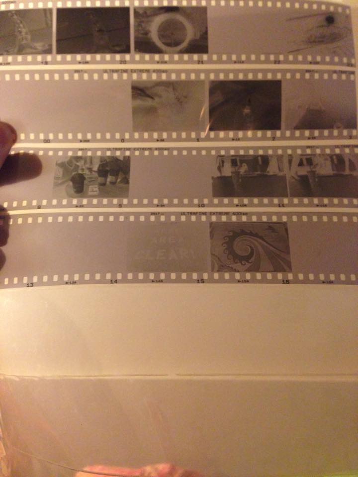

I've been using a Canon EOS Rebel S II for the past month as I am new to film photography (first year in school) and I've noticed that after developing my film roll, frames are being skipped and are completely blank. Since I'm a newbie I don't know whether I'm not getting enough exposure or my camera is skipping frames and not taking in light at all. Please help. My grades depend on it haha.

Oct 28, 2014
4
My camera is normally off and stored away safely when unattended and most of my pictures are taken out in daylight.
I've shot the camera opened this morning and it seems the shutter fired just fine each time.
But yeah, these are my shots right here.

Sure looks like intermittent shutter operation or malfunction. The completely blank frames next to exposed frames are the giveaway. This is one of those auto film handling cameras isn't it? As already pointed out the shutter blades moving do not mean they are exposing film. I don't think it is too common with these vertical travel segmented shutters but I suppose the leading and trailing sets could travel together with no time interval between them thus producing a blank frame.
