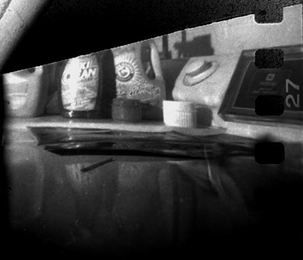

it worked!
the superturbo Wingass model X-5000 camera-in-a-bottle worked!
just a boring half-frame image of bottles of detergent sitting on top of the dryer in the laundry room...but...it worked!
now I need to make a cooler camera that will take better images, and maybe take a whole roll of film

here's the first image from the bottlecam:
( the weird triangular area at the top isn't part of the image )
