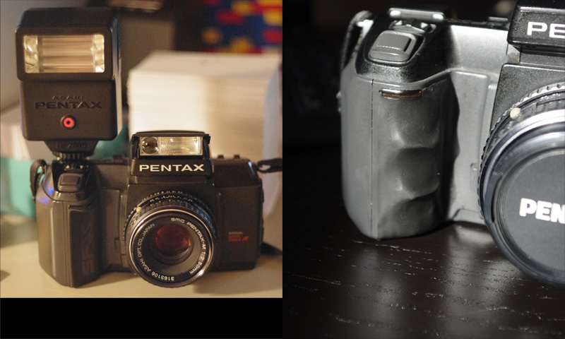

You could try sugru, I made a grip for my Pentax SFXn from that stuff. With a little bit of practice you could form something around a piece of wood maybe? Or, if you want something smaller, you could attach it directly to your camera. That's what I did.
check it: sugru.com
cheers
