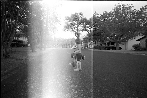

Just stepped out of the darkroom and am drying some negs from one of my Minolta XG-1 (HP5) and noticed that a few frames have dark marks on them and some frames seem to not have the space in between (like the are dark as a neg = light in reverse)! They are still hanging, so I haven't had a chance to really investigate, but I'm wondering if it could have been me rushing in the darkroom and loading them wrong or if my film advance thingy is acting up. I will post an example this evening when they are dry; but wondering in the mean time if anyone has any experience with this.

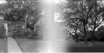

Well crap. Scanned a few and it looks like a light leak for sure. Here are two random shots that are affected :
first one is mid frame
second is between frames

Not sure it is a light leak; according to the manual this camera has a horizontal-traverse focal plane shutter. If the two curtains moving horizontally are out of sync you may end up with such vertical band that looks like a flare. I'm not a technician, this is my 2c in the matter. I hope more people chime in. This camera is 30+ years old, it may need a CLA.

Definitely looks like a camera problem. Problems during development don't often leave sharp straight lines of demarcation. A problem with the shutter or film advance could create patterns such as you have shown.

Check first that it isn't a light leak due to the back not closing properly. How are the light seals?

Back closes firmly and tightly - seals are there - sorta degraded, though. The outward side is sticky in the area where it seals up, though.
Want to point out that the line is always there, now that I look closely. It's either a sharp white line, or a faint wide bar. It moves along the frame in each shot and is not in the same location. Would that be a curtain seam or a shutter issue?
Either way, I have a backup body that was donated to me (since I LOVE this little camera so much, I had to have another one) but it's the same age, and I am wondering if it will eventually meet this same fate.

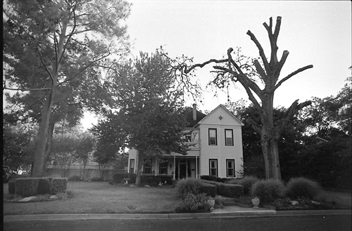

Some more frames to study: (note, example #5 was on a previous role of film ... and when I started to notice this happen - and it was less prevalent then)

Looks like perhaps your shutter curtains are not coming to rest in a closed position after a shot, but before you advance the film (and even while you are advancing the film in your case). This lets light pipe in until you advance the film/cock the shutter.
If this is the case, the longer you wait before advancing the film, the denser the light leak will be on the frame. Using that premise, you can test this on a tripod. Do some shots where you advance immediately. Do others where you wait different periods of time before advancing. Do others where you cover the lens immediately after taking a shot, and then advance the film with the lens covered. But don't change the position of the camera between shots. The amount of light coming in will not be constant shot to shot if you are moving the camera. Make sure to keep track of what you did on each frame.

Had this problem on a nikon em. The light leak came in from door hinge area. Foam was breaking down. A thick piece of black tape on the hinge and a test roll proved it. Refoamed and it's working fine again.
This lines change place because as exposed film is rolled to the right, a different section is exposed based on the changing diameter or the spooling.
If you take pictures at night, or consecutive images with your hand on the side hinge these leaks won't be there. The second you let you camera down into the light like by hanging around the neck, the previous frame will have that streak. Check your previous shots

A shutter fault ought to be in roughly the same place each frame. What about a faulty light seal on the cassette letting light in during loading/unloading? That would explain the fogging being in different places. Are you using a reloadable or shop-bought cassette? Are the less affected frames earlier in the roll?
The light seal at the door hinge gives the same effect described above.
The easiest test would be to tape the hinge with an opaque tape.

It is sometimes just a distinct white line and sometimes a wide band. It also varies it's location across The frame. Upon further inspection of both bodies, the foam is completely degraded along the hinge of the back. I will try tape - run a test roll - and if it works, will re foam both bodies. Is this a DIY job?
