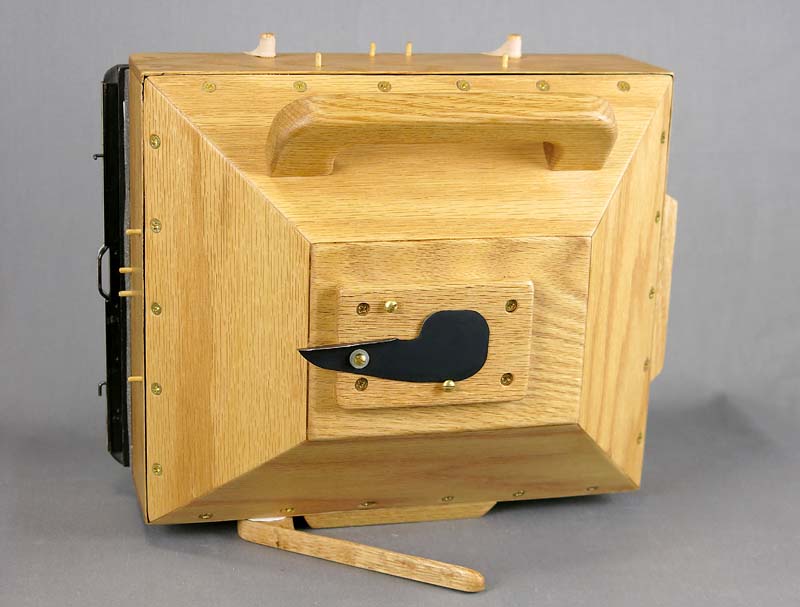

Enh, you just need a "kick stand" :D
attachment.php
That's an 8x10 pinhole camera but I could picture an alumin(i)um strut pivoted on a widget in the tripod socket for 35mm.

Holy Moly, what a beautiful camera.
Voigtlander folders from the 50's all seem to have the little foot needed to stay level.
