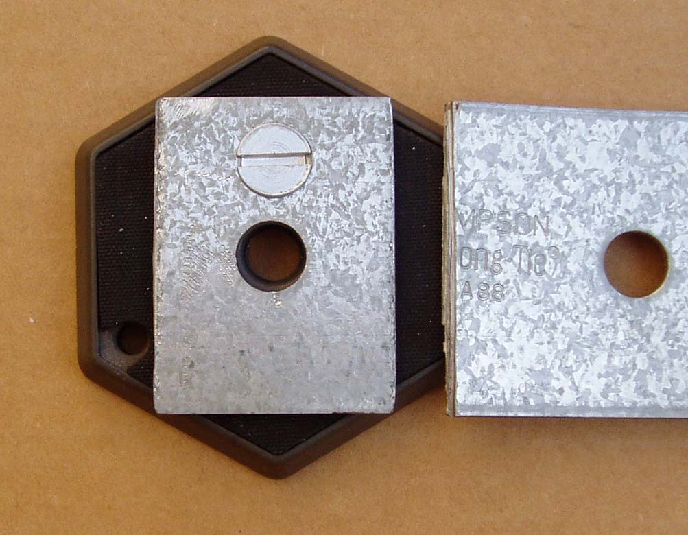

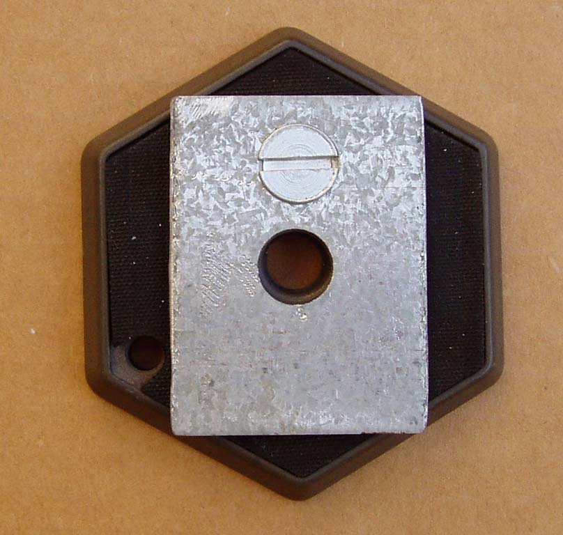

I made a spacer to fill in the gap. I used a piece of a Simpson Strong-tie corner angle #A88 that I had left over from when I built my darkroom. It is just the right thickness.
I attached a couple of photos , I attached the spacer to a Bogen hex plate.

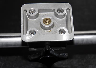

Success!
I got the tripod adapter back from the machine shop. Now it fits any tripod easily.
