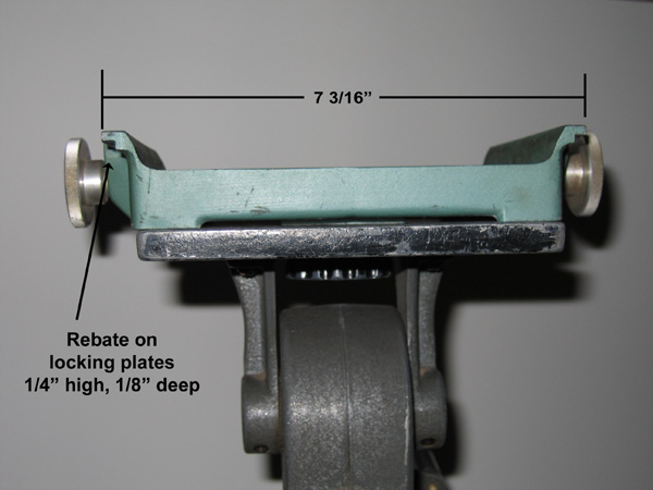

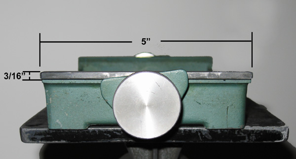

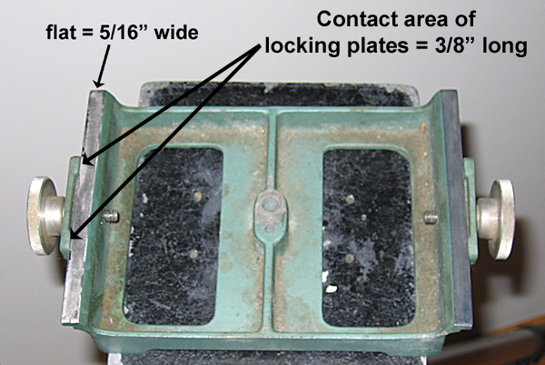

OK, mine is not a homegrown, it's the stock plate. Here are some pix with dimensions indicated. Any questions, drop me a PM.
I should add, mine stays on the tripod head...
billschwab said:
Thanks Bob! Just a snap or 2 of what you did would be great. Can you post it here? I can also PM you with an address.
Much appreciated. My thought is to start with a block of oak that I will route a grove into the sides to run along the bottom lip of the rail. I'll counter-sink a 1/4 x 20 Tee Nut into the center and back it with a metal plate to keep it secure. Then I'll fashion some sort of thumb screw/plate locking device to keep it in place. It just might work. For the long run, I may mill the parts out of Aluminum... we'll see how this works fiirst.
Seeing what you did will be a big help.
Thanks, Bill
