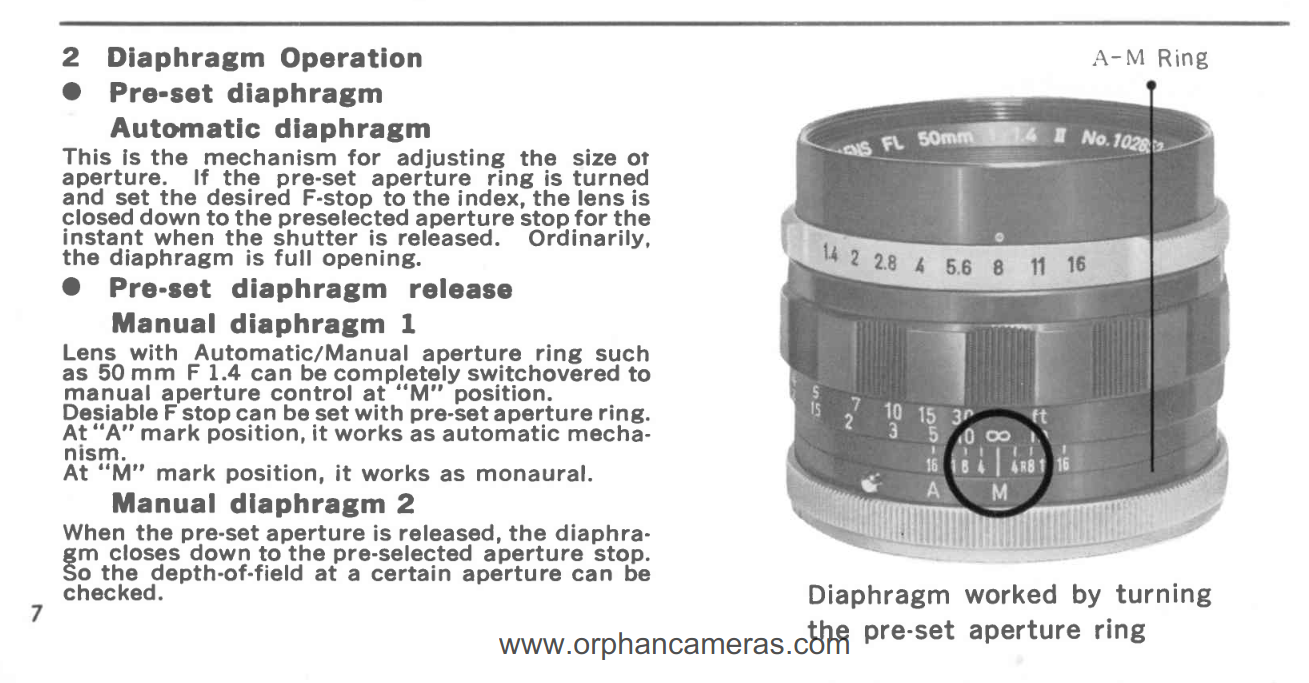

I just bought (or stole) a cheap Canon FT QL.
Came with the 50mm 1:4 lens: A-M ring, no "white dot" extra ring.
like this example.
This may be a silly question...
A-M ring, currently set to "A". Aperture ring is nice and free, but no blade movement, of course.
I do not seem to be able to move ring to the "M" position.
I wonder what I am doing wrong, or if the A-M ring itself is problematic in some way.

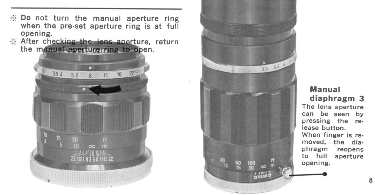

The generic FL lens manual is not providing much guidance, only saying moving to "M" should be not done with aperture wide open.
Notes:
When the lens is off, I can operate the aperture blades using the rear pin
No mercury battery equivalent on hand, so I cannot meter as normal, get lens aperture to do its thing.

"moving to M should be not done with aperture wide open"
This is weird. I have not come across such at my non-FL lenses with such switch.

That's a later design FL lens. Earliest versions had a secondary stop-down ring adjacent to the primary ring. Canon changed to a "A/M" ring at some later time. Some lenses have a locking button (my FL 50/1.4 does), others don't (FL 28/3.5). Normally, depressing the button allows you to move the ring. Check your aperture blades. Any trace of oil? If not, something internal may be amiss.

Don't you have to use FL lenses in stop down metering mode on a FT QL? Pretty sure those are pre set lenses. A = wide open, M = closed to the preset setting. I guess on the later lenses it doesn't work like that, not unless the aperture blades are stuck. The lens should stop down in M mode.
Also, try firing the camera w/ the back open to see if maybe the blades are trying to open or not at different aperture settings w/ the lens mounted on the camera.

The Canon FL series require stop down metering, but have automatic aperture. A means the camera will stop down the aperture, M- the aperture stops down manually.
I checked this at my only Canon FL-lens, 35mm F2.5:
1) at aperture setting at full open that switch cannot be moved, the setting must be at some stop down
2) with the aperture setting at some stop down, with the switch the diaphragm can be closed down to that stop, and opened again
3) at this setting by twisting the aperture ring, the diaphragm can be opened to larger apertures, but not closed to smaller ones
Point 3 is a malfunction according to the zoom lens manual, the primary lens manual does not cover it. But setting each aperture singulary by operating two rings would be most bothering at manual operation.
Now I likely got yet another lens to repair...

This is the only reference I found, the "Canon FL lenses Manual":
Now, it would appear that I can set shutter speed and aperture manually in "A" mode, which would suit me.

Yes, this is the one I referred to as primary-lens manual.
Anyway, at your lens that switch does not work at all, at my lens is works only at a most impractical and deceiving way.

I have an FT with the 50mm 1.4 lens the OP linked to in the first post. With my lens on A, the aperture remains open until I press the stop-down lever or fire the shutter. With it on M, the aperture moves as I move the aperture ring and stays at the selected setting. The 50mm 1.8 I have (was the lens my dad used with his TL) works identically.
