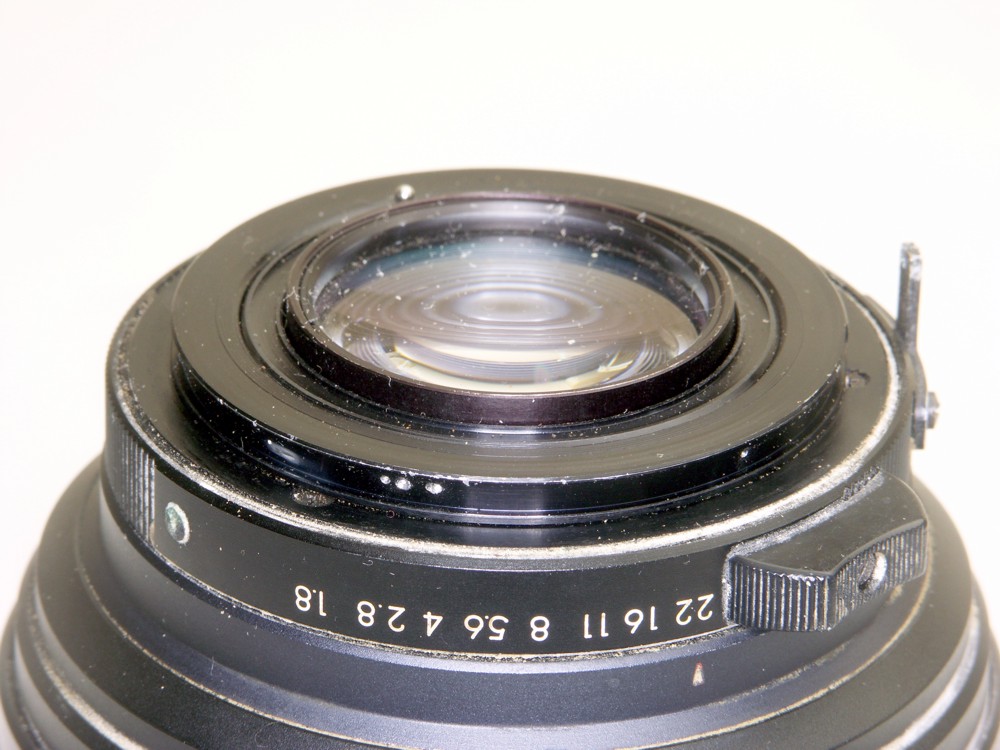

Here are two photos of one of my YS lenses -- they are almost exactly the same. The first shows the lens with the YS mount ON, the second with the YS mount OFF.
You can see in the second photo that there are no threads at all -- so no way to attach a T-mount as has been suggested on the BUTKUS website.
To me, it would be very odd for Sigma to develop an alternative to the T-system that would somehow allow a T-mount to be used. The width of the unthreaded ring on the YS lens that attaches to the YS mount (with three screws) is 52mm -- MUCH wider than the 42mm T-mount thread.
This is OK with me, because the YS mounts I have work fine, but having a T-mount as well would add some versatility for me.
Until I see otherwise, maybe this just proves, once again, that you can't believe everything you read on the Internet.

I think the thing in your picture is the inner part of a mount, like a two-part T mount. That is, the mount has an inner threaded collar, and then an outer part with the camera mount flanges and setscrews that pin the outer to the inner. The inner part should screw off the lens if you can get a grip on it (or if you reassemble it and use the outer as a grip). This inner-outer arrangement and the setscrews allow the user to adjust the angle of the lens relative to the body if it doesn't wind up exactly aligned once mounted, as with many T-mount accessories. I don't have a YS mount lens to experiment on, though.
xkaes
Mar 25, 2006
4,986
Colorado
Thanks for the thoughts. Apparently the YS mount is not as common as I would have guessed.
If you look at the second picture, there is nothing left on the lens to remove. The only thing there is, is the aperture ring. That is not adjustable, of course (the YS mount is what is adjustable, as with a T2-adpater) and removing the f-stop dial would only screw-up the lens. In addition, if there is a T-mount under there, screwing in a T-mount would eliminate the aperture ring.

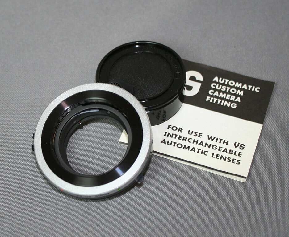

Here is a picture of a new mount -- exactly like the ones I have -- from EBAY today. This is the entire YS mount. There is no thread of any diameter on the front. I've removed this same mount from my two lenses, and there is no thread underneath on the lens -- just a 52mm ring that the three side-screws press up against.
The first picture on the BUTKUS webspage (showing a YS Nikon mount being attached) shows the mount BEHIND the aperture ring. The f-stop dial is part of the lens -- just like in my second photo (above) -- and the YS mount is attached behind the f-stop ring -- as in my first photo.
As to the BUTKUS web page, if it is a transcription, it's a pretty poor one because there are contradictions -- and what looks like some "ad lib".
So I'm as confused as ever. The two YS mounts and lenses that I have all work fine, so I'll just leave it at that.
Maybe I can get this EBAY seller to send me a copy of the instruction sheet -- AND SEND IT TO BUTKUS!!!

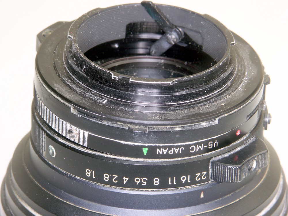

I'm willing to bet that the thin ring I've marked in red is screwed on to a T thread that I've marked in blue.
I was saying so from the start...
One has to mount the outer (dedicated) part again, set the set-screws firmly and twist off the complete adapter. If this does not work, screw out the set-screws again, take off the outer part of the adapter and proceed with the alternatives I gave above.
xkaes
Mar 25, 2006
4,986
Colorado
You nailed it.
I tried that approach on one, but it wouldn't budge. But on the other one, only a little encouragement was needed. I managed to force the other one off without any damage.
Now I can use both of these lenses on other cameras with T2-mounts. I'll keep my eyes open for other YS mounts -- there are lots of them on EBAY but the prices are all over the place, from $10 to $100.
Thanks for helping me solve this problem!!! I hope it helps out others as well.
