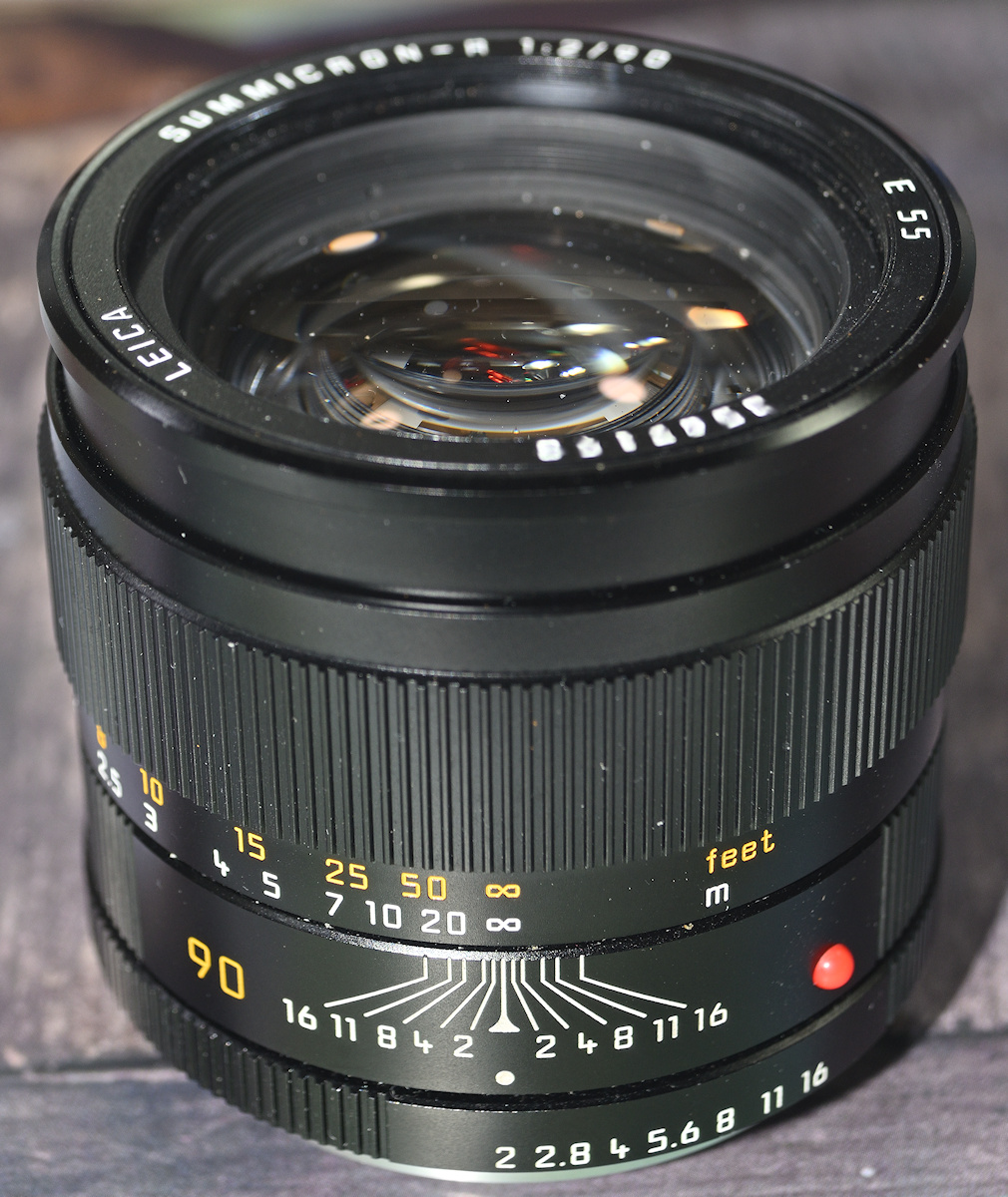

on Friday I wrote about a LEICA Summicron-R 1:2/90 which looked like having a simple problem. Now I know better:

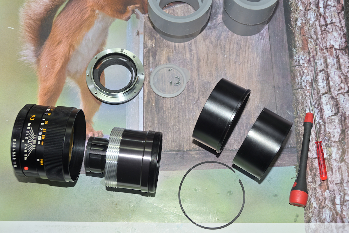

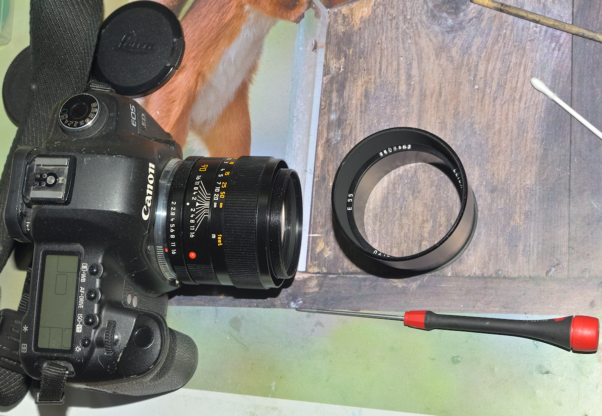

I received a Leica Summicron-R 1:2/90 for repair, whose focus setting is not correct.
This is actually a very simple job - you unscrew the outer front tube with the lens hood from the lens tube, then use a long screwdriver to loosen the four fixing screws on the clamping ring, turn the lens tube until the focus is in place, and tighten the screws again:
However, it was not possible to unscrew the tube with the lens hood using the usual tools (rubber stopper or piece of tube with rubber edge) because the tube was extremely tight and the friction of the rubber was not enough to loosen it.
So I had to disassemble the lens from the back and remove the lens hood from the outer front barrel in order to unscrew the front barrel from the lens barrel using two oil filter wrenches (rubber-coated textile strap with a lashing handle).
Then I reassembled the lens except for the outer front tube and glued the stop ring back to the lens hood.
Now the focus adjustment, as described above, was no longer a problem.
After that, all that was needed was to screw the outer front tube with the lens hood back on.
I have obscured the serial number of the lens shown here because it is a customer lens.
