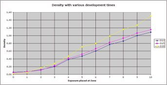

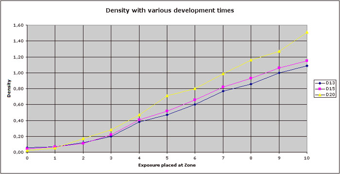

I am trying to calibrate my system according to Ansel's The Negative: find the right film speed to use by finding the speed at which Zone II produces a density of about 0.10 and then find the right developing time by testing where the density of Zone VIII is 1.25 to 1.35 (diffusion enlarger).
My film speed is closest to 400, which is of course the rated speed of the film.
My development times seem however to be way to long. To test this I did the following:
I shot three rolls (120) of film of a grey card, exposing from Zone 0 to Zone X on each roll. I then developed one roll for 13' (Ilford's recommended development time), one for 15' and one for 20' at exactly 20° in fresh (made several hours earlier) ID-11 diluted 1:1 with distilled water. I agitated the tanks for 10 seconds at the beginning of each minute. The graph shows my results. Not even at 20' do I get a density of near 1.3 for Zone VIII, although Ansel's recommended Zone V density of 0.65 - 0.75 for diffusion enlargers is met at 20'.
I measured the density with my Heiland Splitgrade system, zeroing on film base + fog (unexposed) on each roll and then measuring each exposure.
These results more or less match my experience that my negatives are often too flat, so I often need to print at grade 4 or higher. The tests are all from a batch of film I've had for a while, expiry date January 2006 but kept in my refrigerator.
Has anyone else gotten similar results? Is my film no good anymore? Are my methods faulty?

Please note that I am too stupid to get the X axis right in Excel: the values should read 0 to 10 (the exposure zones) instead of 1 to 11!
On the graph in Excel, try putting in numerical values for 0 through 10 in a corresponding row or column, then choose an x-y line graph and plot the row/column for density against the corresponding Zone numbers on the y axis.
In the case of the data in your attachment, renumber the cells in the first row as 0 through 10 and then plot the first row as the x-axis value against rows 2 through 4 in an X-Y graph.
