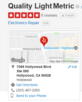

Send it off to Quality Light Metric. I use him to calibrate my Pentax Digital Spot Meter. George charged me $88US plus shipping in October [actually I drove over and dropped it off and picked it up the next day.] and when I had some questions last month he had me send it in and he calibrated it for free. He is highly recommended and the movie industry in Hollywood uses him very heavily. https://www.facebook.com/pages/Quality-Light-Metric/554305868044042

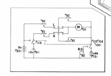

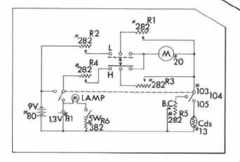

ic-racer, is that the digital spotmeter? I didn't know it used 9v source, had a high-low switch and a light bulb.
p.s. Though it's off a stop at one particular light level, it may have a linearity issue as well - (might be accurate in low light for instance but off in daylight). So if you can calibrate it that would be great.

Contact information if someone wants to use him.

How about
No doubt about it , that's definitely the one now !
Wrong side of the world for me , but will be very useful for folk on your side of the pond .
As it happens , even over here , I seem to remember being recommend to them before as a very good service centre .
That schematic is for the one in the picture below. It is the only Pentax spot repair manual I know of. Though there may be more. I wound up not needing the manual, because I got a Sekonic meter instead. I don't have the service manual for my Sekonic meter, but probably will never need it. The Sekonic is nice because it has a digital calibration via a menu and if it breaks I can just get a new one.
