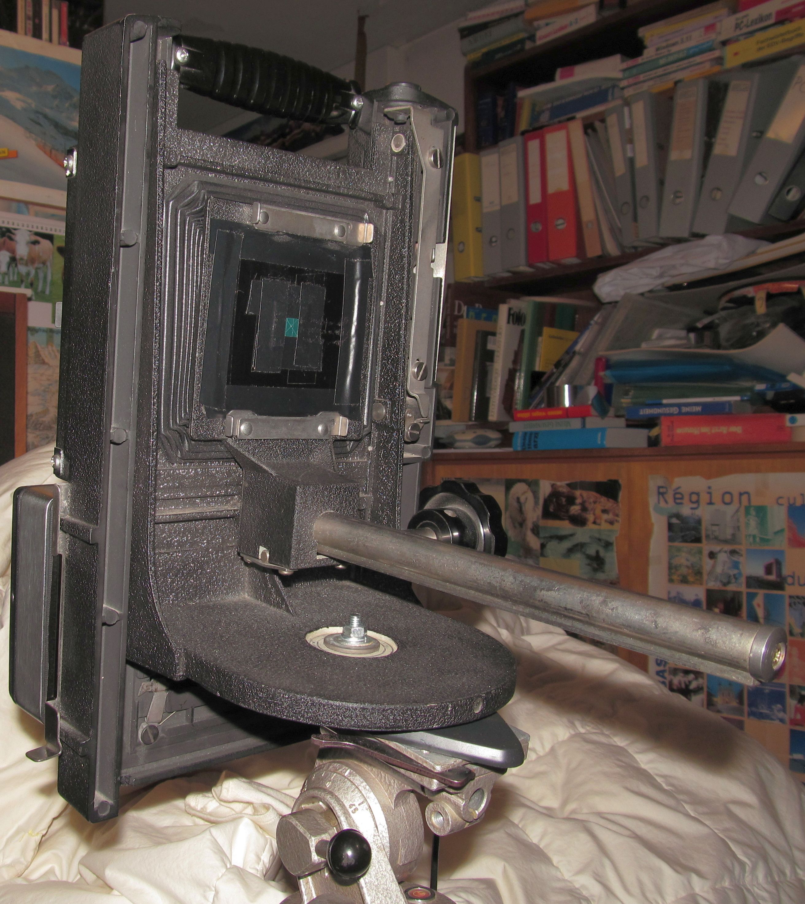

Received a Polaroid MP3 with pinhole taped into board-hole.
When bellows are closed i calculared 40mm FL.
If i am holding led-light(one pin) directly onto pinhole it will be projected to groundglass.
Can the size of this projection tell me the size of the pinhole?
How ist it calculated?
pinhole-size leads to a certain FL-range i was told.
When bellows are closed i calculated approx 65mm FL. CORRECTED(not 40mm)
pinhole-size leads to a certain FL-range i was told.View attachment 158584
NB: Shinkphoto/skinpinhole has a copal-0-set with pinhole, Zone Plate an Zone sieve. If no shutter is used 30mm hole must be drilled into lens-board. NB; ist linhof 82.5 x82.5mm
63-65mm not 40mm min. bellows collapsed.
frame is 49x49mm approx.

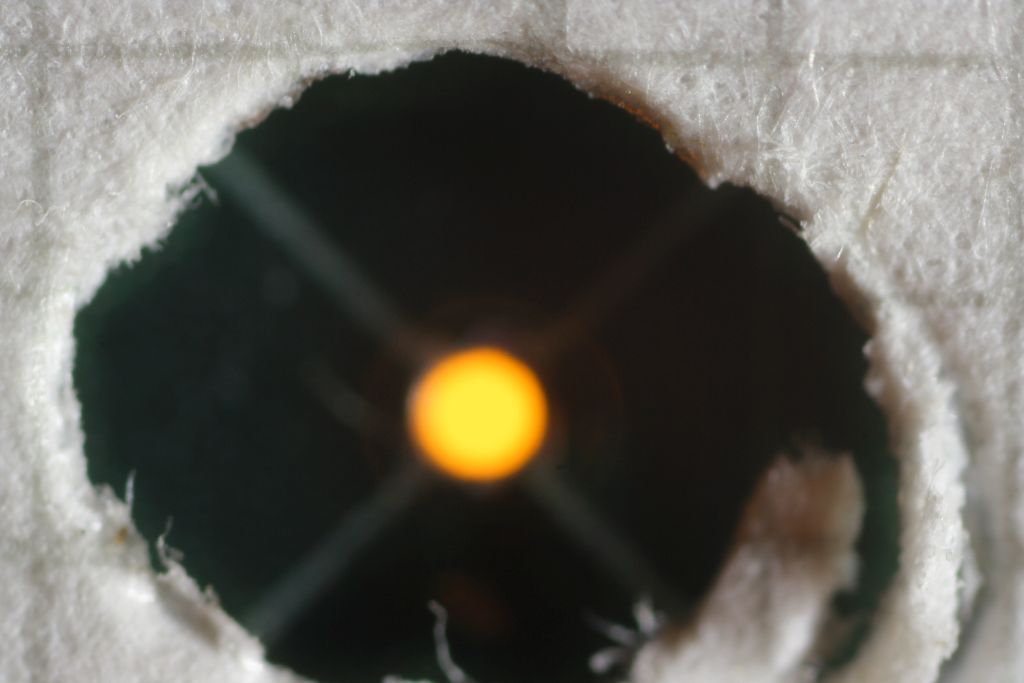

Have it now. took an 6x image with 35mm macrolens canon on contax macrostand.
pinhole is 4.54 mm
chip: 22.2mm
image-ratio 0.1056511
resulting in 4.54mm pinhole
http://www.mrpinhole.com/calcpinh.php
is telling: ideal FL 116mm f256
70.9 degr. 223mm image
on 4x5 inch 164mm diagonal
125 iso- sunny rule 2.04sec.
Pity i dont have it in shutter-could have prontor professional timer used.
but later when i have skinkpinhole(photo) copal 0(adapted for copal 1)
Shift: with shutter only +-5mm. Is it worth with 116mm 71°?
if only zeroimage would sell the shutter alone. with mentioned timer 2-32sec. exp. times possible.
Without shutter: +-19mm shift will wait until i have shinkphoto copal 1(30mm hole needed) set to see which shift is really possible with it.
but with zoneplate and sieve i need a shutter anyway. except when using ultra-low-speed-film.
first image showing mm-paper- 4.2mm horizontal shown
second image focussed on pinhole 0.455mm

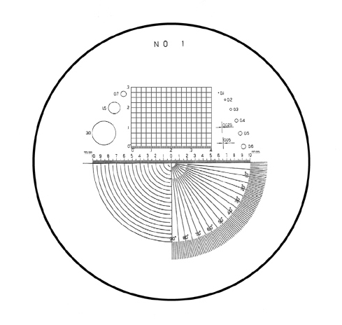

I am lucky have found a peak-loupe with multiple scales and even pinholes-on 0.1mm steps only but there is also a 0.1mm scale which is telling me that the pinhole here is right inbetween 0.4 and 0.5. could visualize by handholding against strong light! maybe on peak-site or elsewhere one can view the scales.

Will do later: Its called PEAK Scale Lupe 10x (Lupe is german). it has a transparent ring to use external light from the sides.
it should be on peak-site. I have it with the leather bag.
TheToadMen
Sep 18, 2012
3,570
Netherlands, EU
Pinhole
You mean this PEAK Lupe?
