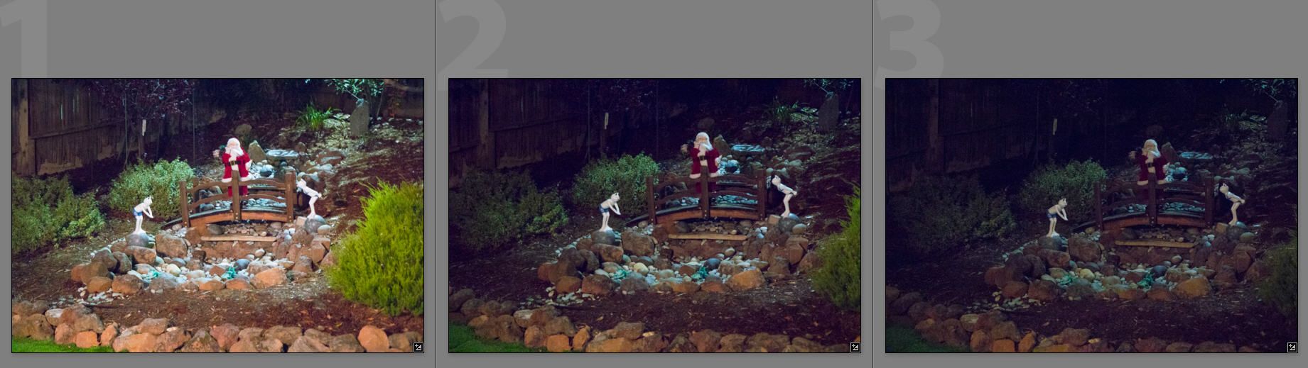

As exemplified by this series of 3 shots just taken tonight via an LED streetlight (but with a spotlight from my house supplementing what the LED streetlight provided).
Exposures at ISO 25600, f/2.8 aperture, and between 1/8 and 1/30 for shutter speed:
What was my definition for 'adequately exposed', where was the brightness of the surrounding area as envisioned by me before I shot?... represented by 1, 2, or 3 or somewhere in between 1 and 3 (but not '2')?!
