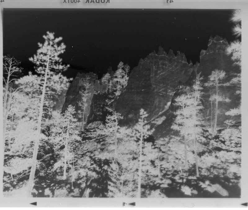

So here's the negative that I got from 5 minutes development in HC110. 5 seconds agitation at first and then 3 seconds every 30 seconds. Lack the contrast as expected but I don't know if this can be improved. Any suggestions?
To me it looks like it has very good contrast with some lack of detail in the deep shadows. All in all, I've seen worst from well exposed negs...
